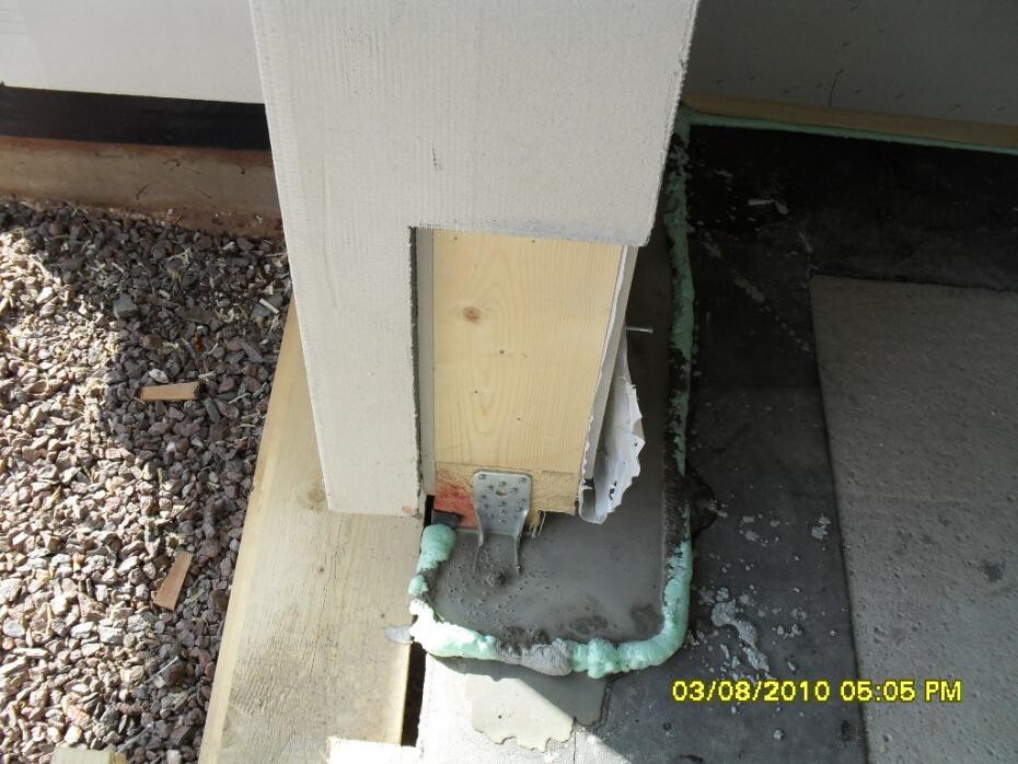

6Richtige20 Aug 2010 15:07Hello everyone,
This should be relatively straightforward. For example, in my houses, the anchoring to the ground is done as shown in the picture, with the walls sealed and screwed together using compressible sealing tape. So later, you only need to remove the gypsum fiber boards, take out the insulation, and dismantle the wooden studs. However, electrical cables might then be exposed in the room, so make sure to plan for that in advance.
