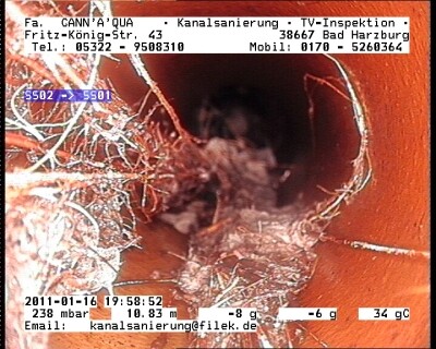

Underground PVC pipes would probably limit us with garden planting because of the roots, right?

Sebastian7919 Oct 2015 20:23But somehow it looks like a cast pipe...?
And if that happens – so what? You just clear it again. If it happened that often, it would be a widespread problem, right?

When it comes to root systems, laypeople often have little idea of how "small" root structures large trees can manage with. Shallow-rooted plants like the rowan shrub should not pose a problem anyway. Deep-rooted plants also do not extend several meters down... It is therefore advisable to familiarize yourself with the root systems of shrubs and then select appropriate plants based on the location of the pipe. The pipe will not be everywhere but will only pass through a small area along the property boundary.
