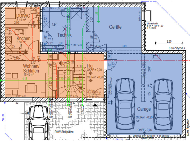

The house has three floors and is built on a slope, with the basement partly underground at the rear and exposed on the front side. The heated area in the basement consists of approximately 30m² (323 sq ft) of living space plus stairwell/hall/entrance area, while the remaining areas are unheated: technical room (14m² (150 sq ft)) and an unheated garage (62m² (668 sq ft)).
The ground floor and upper floor are fully heated.

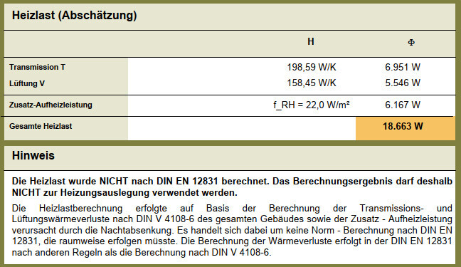

We have an energy certificate according to GEG2020 with the following data:
- Heated building volume: 876m³ (30,925 cu ft)
- Envelope surface area: 576m² (6,200 sq ft)
- Heated air volume: 666m³ (23,518 cu ft)
- Window area: 66m² (710 sq ft)
- Usable floor area according to the Building Energy Act (Gebäudeenergiegesetz): 280m² (3,014 sq ft)
- Primary energy demand: 44.41 kWh/(m²·a)
- Transmission heat loss coefficient: 0.345 W/(m²·K)
- Transmission heat loss: 6,951 W
- Ventilation heat loss: 5,546 W
- Additional heating load: 6,167 W
- Total heating load: 18,663 W
(Boundary conditions: outdoor temperature -14°C (7°F), indoor temperature 21°C (70°F))

KarstenausNRW10 Aug 2023 13:23Herdeler schrieb:
With controlled residential ventilation, I come to 6700W, without controlled residential ventilation to 8200W. How do you arrive at that? Is it due to the postal code? I used the values from the original post and get different results with the same tool.

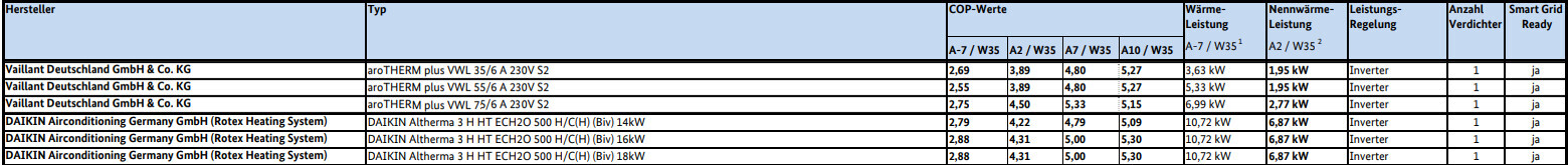

The values come from the BAFA list:
...and here I wonder why the Daikin units have the same performance ratings in all three sizes?!

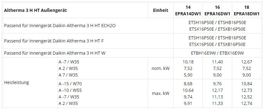

What I haven’t figured out yet is why the Daikin heat pump on the BAFA list shows different COP values for three different unit sizes but lists the same heating capacity and nominal heating capacity. On online shops, the nominal heating capacity is the same, but the maximum heating capacity varies depending on the unit size:
| Altherma 3 H HT BG14 | 7.52 | 5.9 | 9.91 | 9.74 |
| Altherma 3 H HT BG16 | 7.52 | 9.00 | 11.33 | 11.13 |
| Altherma 3 H HT BG18 | 7.52 | 9.00 | 12.74 | 12.52 |
What exactly should I pay attention to during the system design? Which performance figure can I use if I trust the heating load calculator from @KarstenausNRW, which initially gave me about 7 kW?
//Edit: The table doesn’t work for me, so here is a picture:
