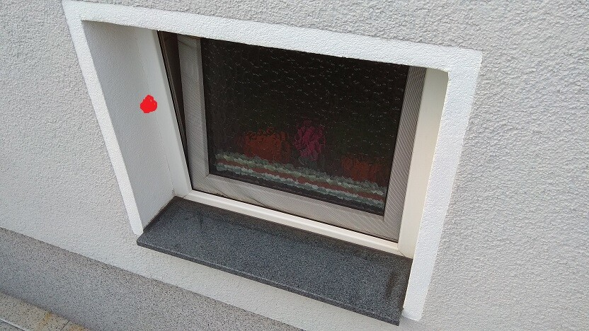

I’ve attached a photo of the corpus delicti here. I was thinking I could drill a larger hole with a big drill at the spot where I marked the red dot. I would do the same on the opposite side, but a bit deeper than necessary. Then I would insert the steel rod from the outside, center it, and fill both sides with cement.
Without having measured yet, there should still be enough solid material on the outside before the thermal insulation starts, so that no one could "pull out" the rod.
What do you think of this plan?

What do you think about the project? I think the picture has made it understandable for the first time.
Yes, that definitely sounds feasible.
Cutting a typical stainless steel handrail (maybe 8cm (3 inches) in diameter) and placing it centrally in front of the window, either horizontally or two vertically.Hmm, I cut through the handrail with a manual metal saw in under 60 seconds.
I’ll do the same on the opposite side, just a bit lower than necessary.How far should the pipe go into the wall on both sides? How do you plan to get cement behind the pipe? Otherwise, I could just push the pipe back into the hole, and the contact between pipe and cement won’t be very good.

How far should the pipe extend into the wall on both sides? How do you plan to get cement behind the pipe? Otherwise, I could just push the pipe back into the hole, and the contact between the pipe and cement won’t be very secure. Maybe about 10 cm (4 inches) on each side. I’ll pack it in as well as I can using a trowel. Once everything has cured, I’d say the pipe won’t move much anymore. Cutting it through is of course possible, but that makes quite a lot of noise at first. Since I live in a terraced house in the middle, hopefully the neighbors will notice. Also, the glass would have to be broken in the process.
