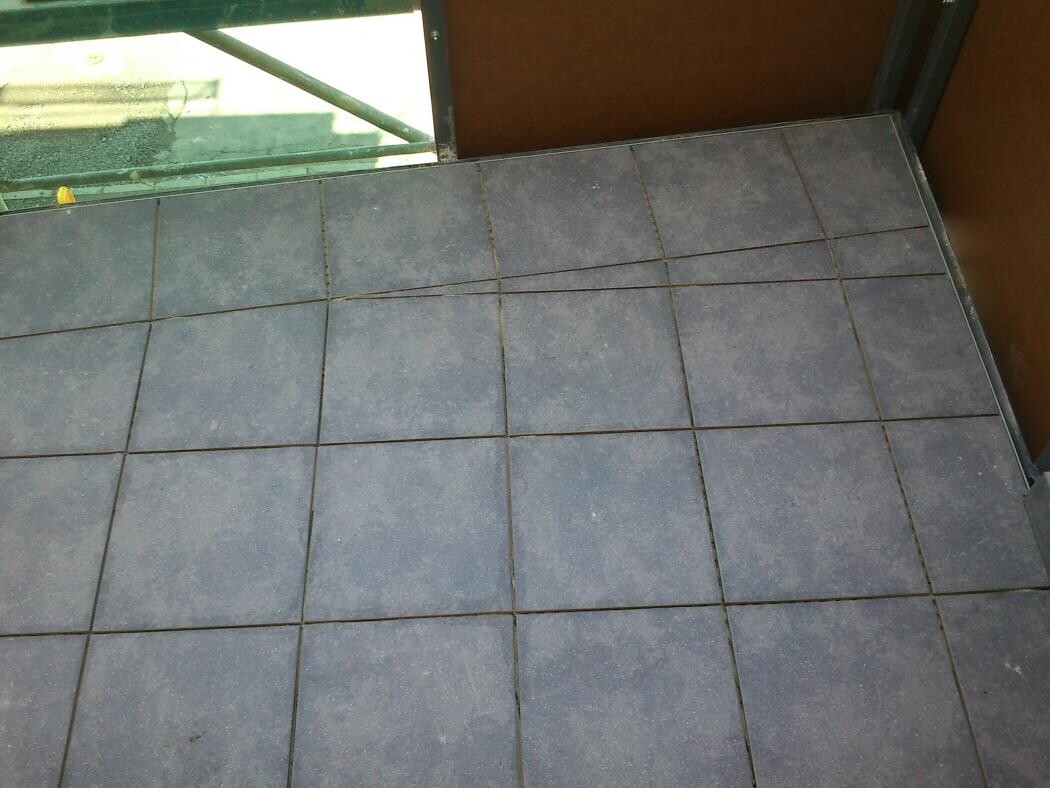

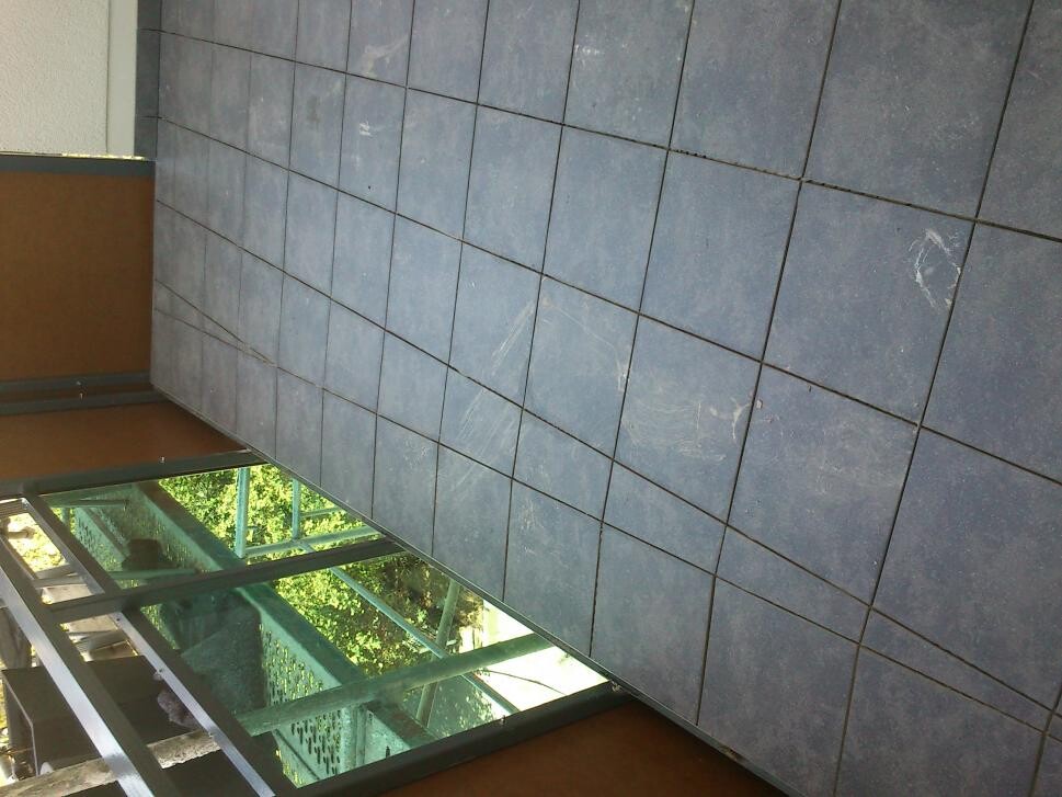

I need to inspect a balcony soon that I am not satisfied with. Could someone tell me if the installation method used has to be accepted as is, or if it is not professionally done?
Interior floor with grey tiles and glass railing.
Grey square terrace tiles on balcony with railing in the background.

As a tiler, I would have been interested to see how this turned out...
I really had to smile when I saw the picture. Of course, you start laying full tiles at the front, but please don’t install a wedge in the middle...
Hopefully, the entire area is properly uncoupled; otherwise, I don’t think the homeowner will enjoy it for long.
