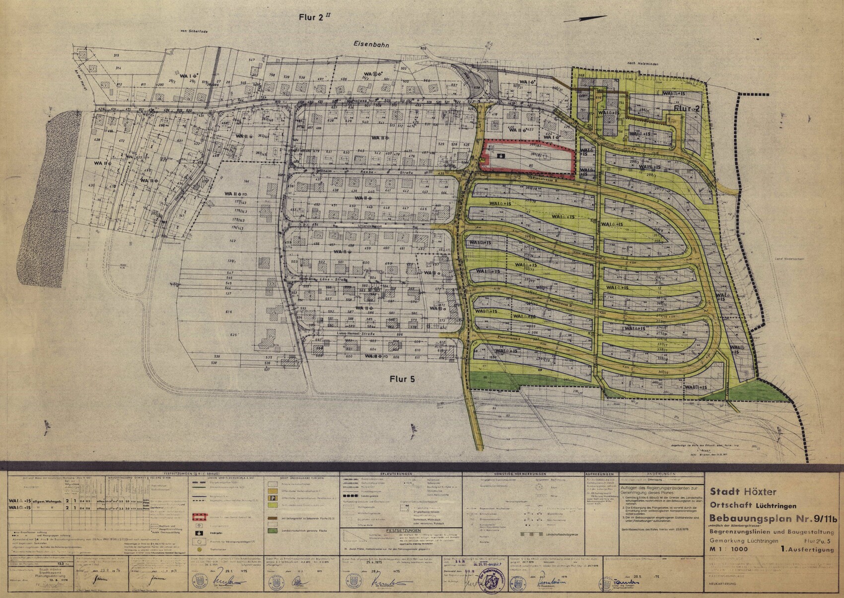

Of course, very gladly. I didn’t expect anyone to take such detailed effort to support us – we would of course be very happy.

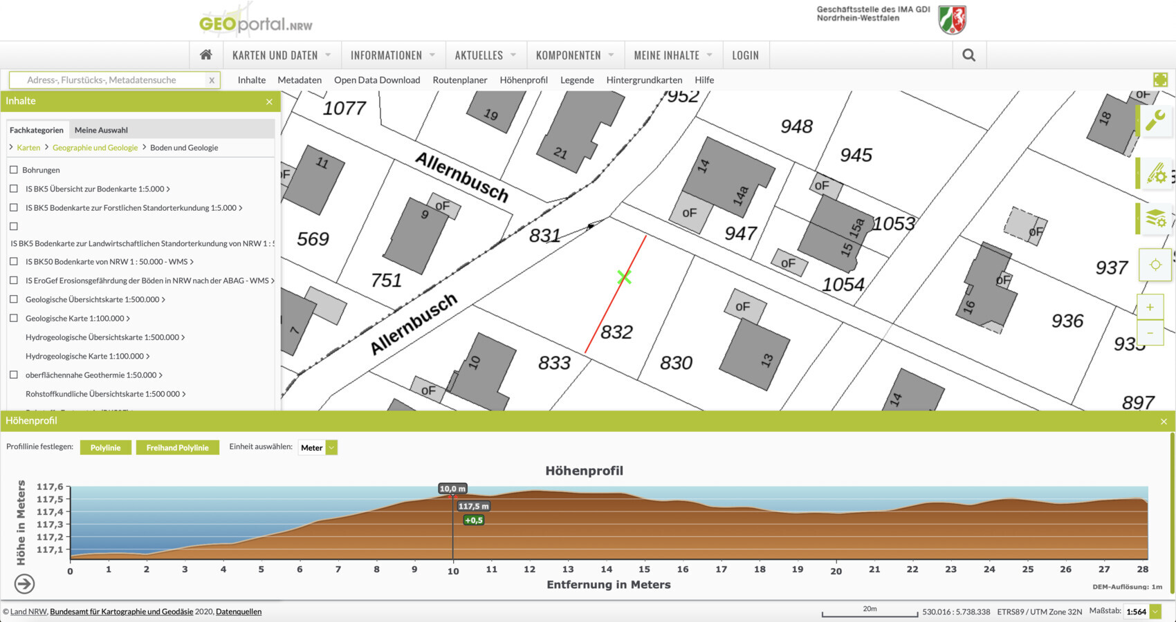

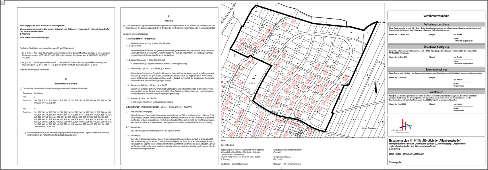

I have attached the development plan including all revisions. It concerns plot number 832. Additionally, there are two cross-sections of the ground included to give an idea of the slope, as well as a satellite image with some basic information.

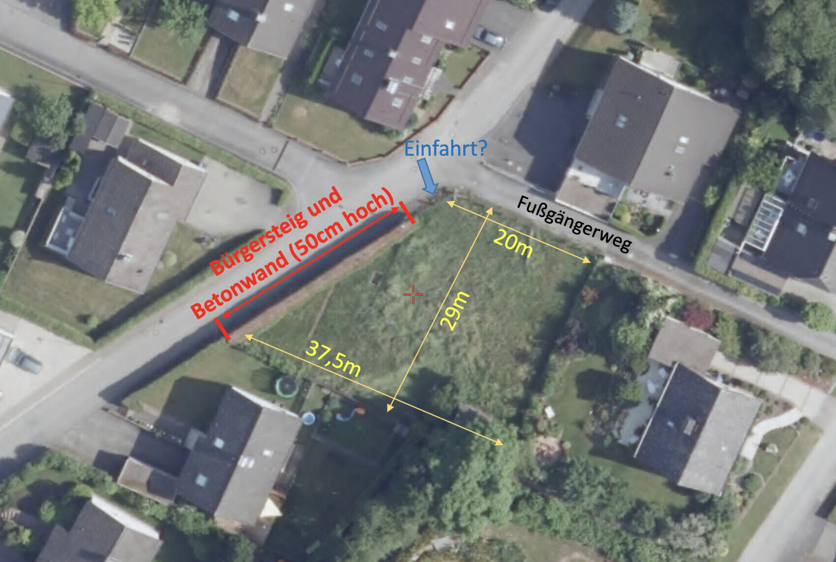

What about plot 831, which I interpret in the drawing as located between the road and the driveway you suggested? It should presumably be allowed to be crossed in order to access your property.

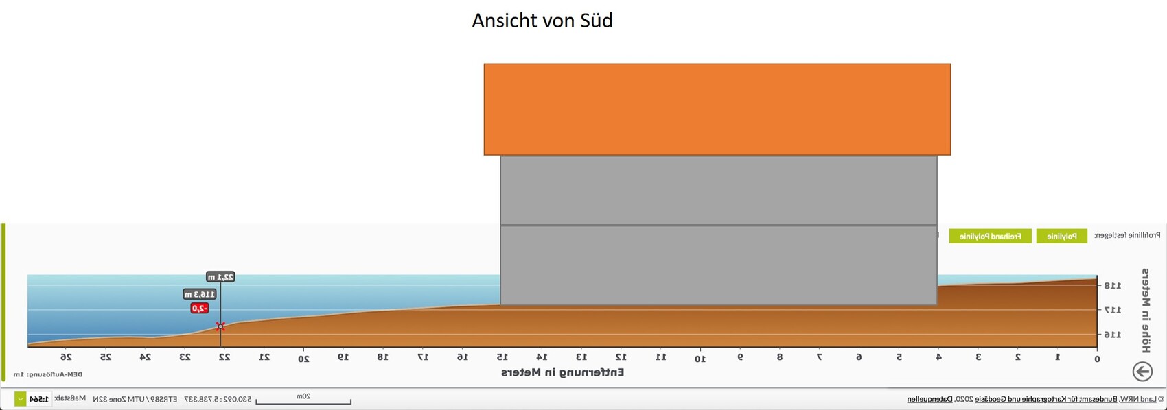

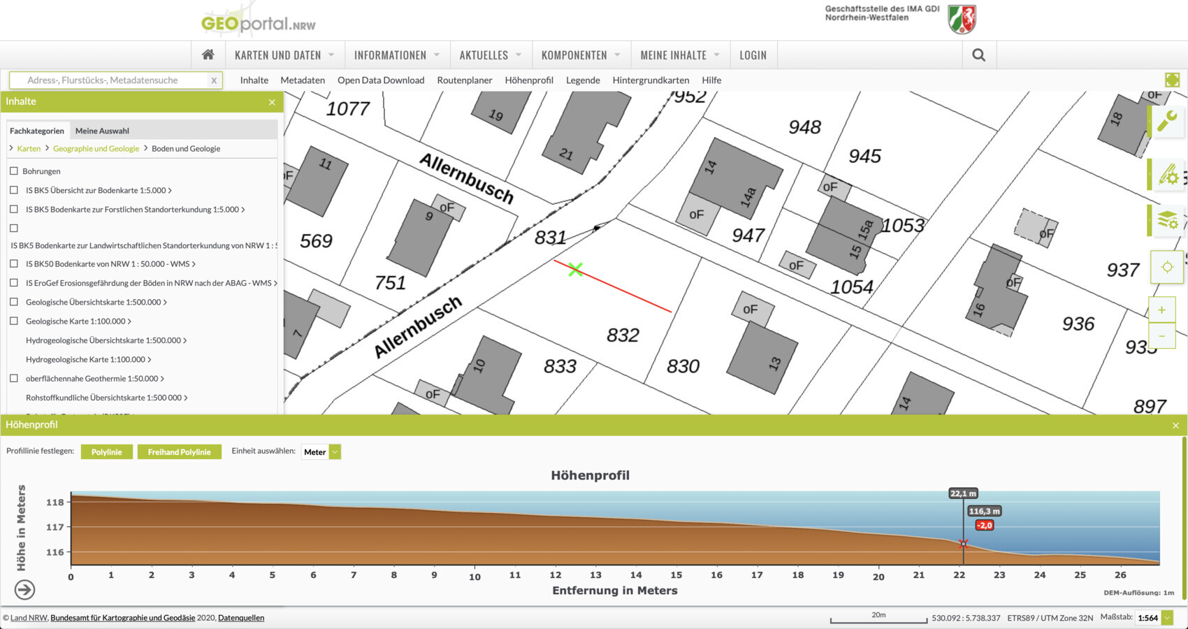

The development plan always mentions a sloped site. From the elevation drawings, I understand that the lowest point of the plot is at the northwest corner (near plot 831).
The height differences north-south are about 0.5m (20 inches), which is almost negligible. More interesting is the west-east direction (the pictures are confusing; it seems the elevation profile is mirrored or viewed from the north, since the chosen height point is closer to the west boundary).
Do you plan to build with a basement? At first glance, I do not see a habitable basement level because the slope is mainly on the sloped part of the lot. If you shift the house towards the northeast on the lot, the slope within the building area is less significant (at least according to my interpretation of the mirrored elevation profile, please correct me if I am wrong).
Whether the driveway, as mentioned by @11ant, may be routed through plot 831 needs to be clarified. However, that would certainly be the best place for it.

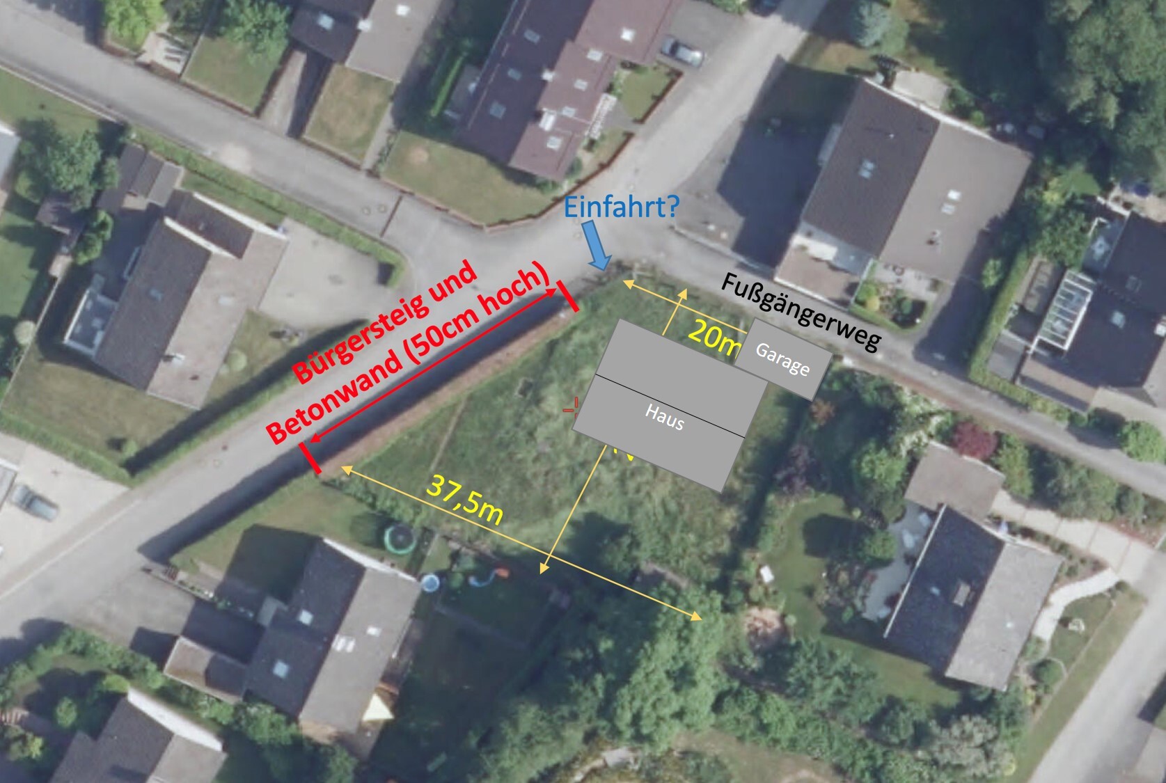

Given the plot shape, I would orient the gable end perpendicular to the slope, even if the immediate neighbors do not do this. Then only a roof pitch of 37° is possible, but since there is sufficient height for a knee wall (short wall beneath the roof), this should not be a problem. Orienting the house perpendicular to the slope results in a larger southwest-facing garden.

b) the exterior design of the house (building height, bay windows, roof pitch, etc.) while considering the local development plan / zoning regulations. This is difficult to answer without any information about the desired house. The plot seems large enough that you could theoretically place almost any house on it. The height restrictions have already been appropriately mentioned by RomeoZwo.
For an initial orientation, I would look at standard house designs, for example from companies like Town & Country, and try placing them on the floor plan as examples. I’m not sure if they specify the heights directly on their website.
For orientation and positioning, start with the arrangement similar to the neighboring houses.
