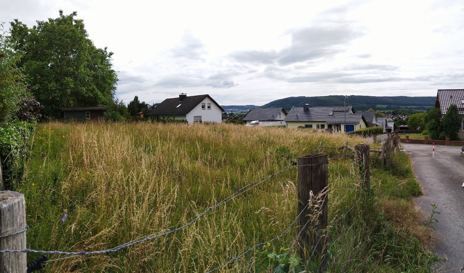

We have now found a plot of land that we like in terms of location, but we are still unsure whether our plans can be realized there. The plot (860 sqm (9,255 sq ft)) is nice but has a slight slope (1-2 meters (3-6.5 feet)) and unfortunately a somewhat awkward shape including building boundary lines.

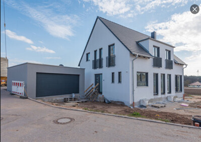

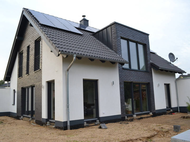

That wouldn’t be a problem since we are not planning a city villa. We would like a house with a gable roof and bay windows that extend up to the top (see photo). Can someone estimate, depending on the development plan, whether this would be permitted here? For the roof, a good balance between pitch and knee wall height would be desirable so that the upper floor can be used as effectively as possible.

Yes, the west-facing side offers a nice view over the Weser Uplands, but mostly from the upper end of the property (or from the upper floor), as the row of houses across the street slightly blocks the view.

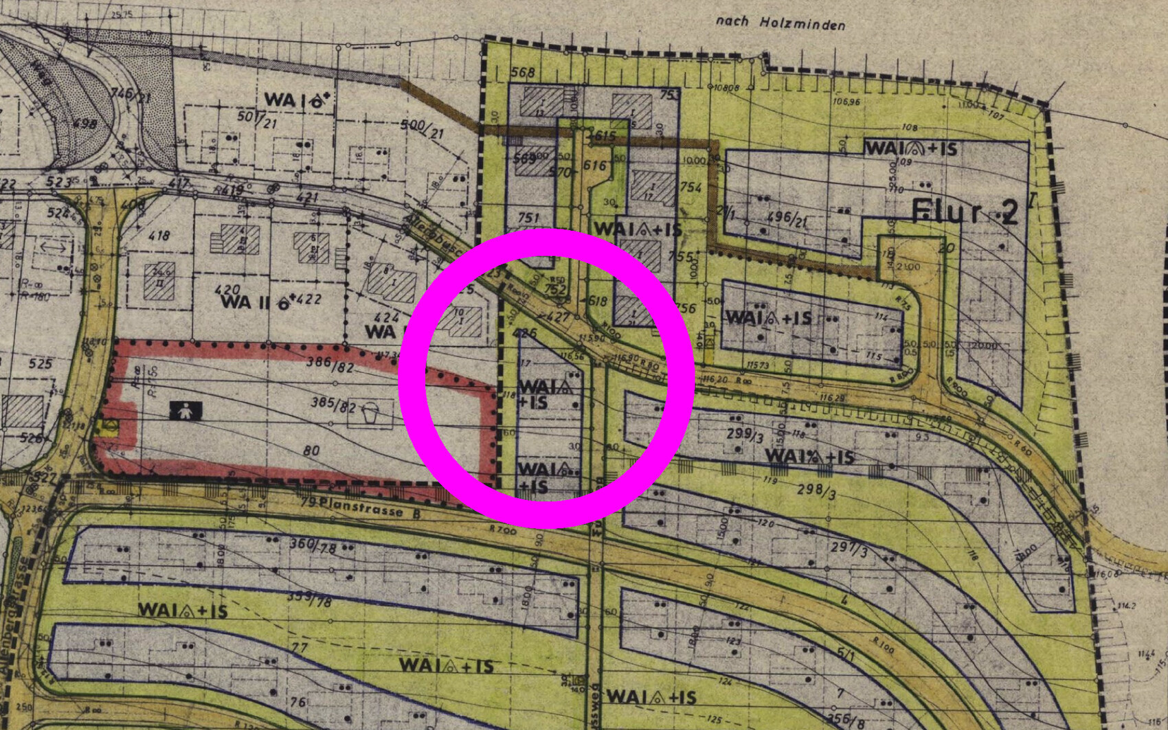

Can someone estimate, based on the zoning plan, whether this would be allowed?No, I can’t: firstly due to the contradictions—section II states roof structures are not permitted, while section III 2.1 allows roof structures on the uphill side up to one third of the eave length; secondly because I cannot clearly assign the plot within the zoning plan, which also hardly specifies ridge direction requirements—however, from the mentioned restriction of no on the valley side and partial allowance on the uphill side, such a thing might possibly be inferred.https://www.instagram.com/11antgmxde/

Can anyone estimate based on the zoning plan whether this would be permitted? Yes. The photo shows a cross gable that is less than half the width of the building. It would be allowed on the uphill side, but not on the downhill side.

Doesn’t the zoning plan specify the ridge direction? Yes. It’s hardly visible because the contour line runs exactly over the ridge line.
gni.w777 schrieb:
Until now I assumed that this is not permitted. Agreed.
Section II states roof extensions are not permitted. Those were the regulations of the original plan from 1978.
Section III 2.1 states roof extensions are allowed on the uphill side up to one third of the eaves length. That was the now obsolete regulation of the first amendment. Also, these are excerpts from the justification. The legally binding regulations are those on the zoning plan certificate of the second amendment (4_b_plan_9_11b_2ae_noerdlich_der_allenbergstrasse_2ae_planzeichnung_sp.jpg).
because I can’t clearly assign the parcel in the zoning plan. gni.w777 schrieb:
I attached the zoning plan including all revisions. Unfortunately not. Mixing plan drawings, textual regulations, and justifications from different versions causes more confusion than help. The first amendment appears to be completely overridden and is therefore irrelevant.

Yes. The photo shows a cross gable that is less than half the width of the building. It would be possible on the uphill side, but not on the downhill side. In the neighborhood, there are a few houses that also seem to have some kind of structure on the downhill side. I would check that out on site. There might still be a small chance if one of the neighbors already has it?

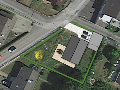

I did some sketches to see what might be possible here. What do you think of this suggestion?
On one hand, I like the terrace facing southwest because of the view and the evening sun. On the other hand, that side faces the street and might be quite visible — so the hedge around it. Garage with an area for trash bins and garden tools. Maybe a door leading into the house could be built here as well. What do you think?
