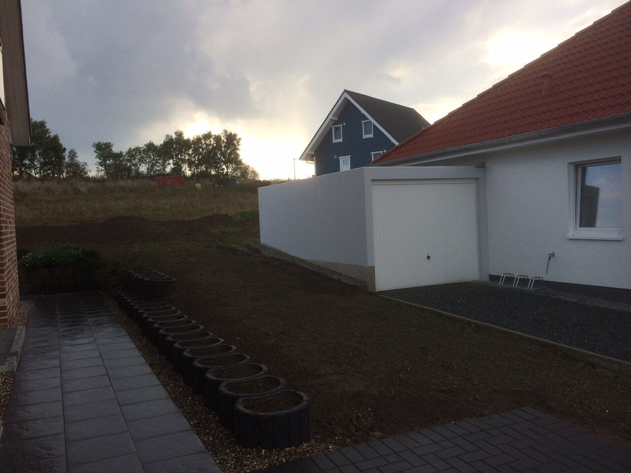

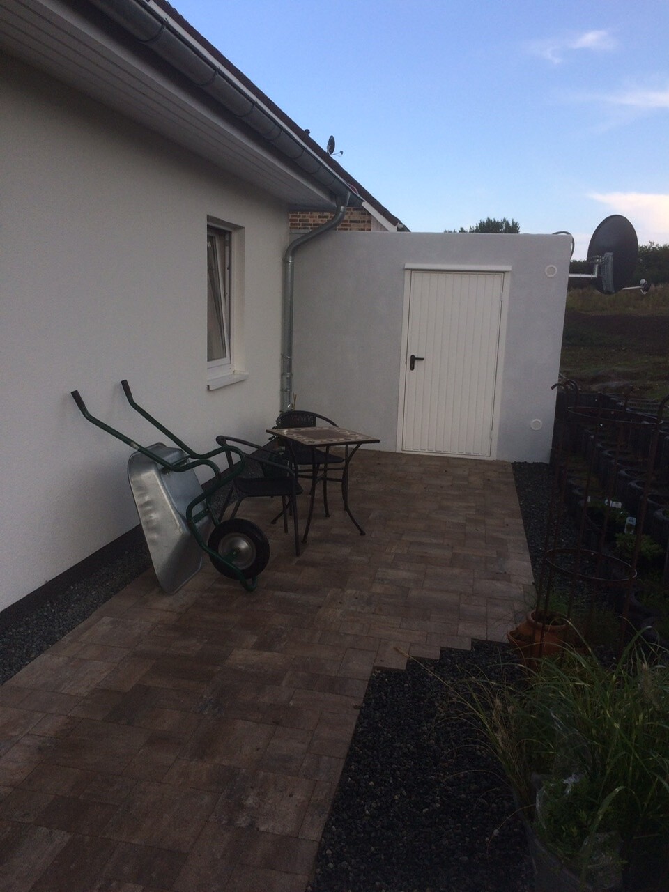

First. Choose a concrete garage. Ours is from Reker, and the quality is excellent.
Second. If the garage is built directly attached to the house, as in our case, it is placed first. Then the house is constructed. The area behind the garage is not plastered, similar to brick cladding, where the aerated concrete blocks or bricks are also left unplastered. There is an air gap between the garage and the house, which should not get wet. Therefore, instead of the garage supplier, a roofer installed a metal flashing on the garage roof and sealed it against the house wall. The vertical joints were sealed with MS polymer sealant. The garage also received an aluminum parapet installed by the roofer.
Third. The electrician handled the garage wiring, which was much cheaper than having Reker do it. An external cable was already included in the construction specifications. The electrician drilled it into the garage, installed a light switch, two power outlets, and one Philips LED light fixture—done.
Fourth. The plaster from Reker is good but tends to get dirty quickly. Therefore, the garage was painted with silicone-based facade paint, just like the entire house.
Fifth. We also mounted the satellite dish on the garage. This way, if any maintenance is needed, everything is accessible with a step ladder.
The price was 8,000 with tax for a six by three meter (20 by 10 feet) garage, door and gate excluded, plus 1,000 for roofer and electrician. Photos were taken before the parapet was installed. Karsten
