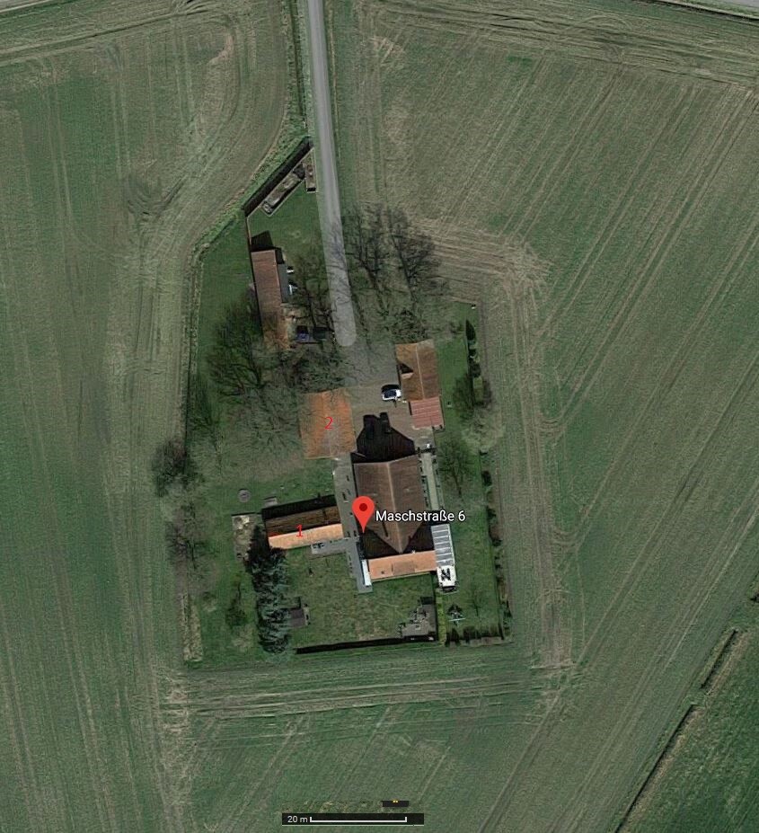

Attached is a photo of the courtyard.
1. The pigsty is the building that should ideally be removed...
2. The threshing barn is the one that would be very difficult to renovate. The masonry shows severe cracks, and the heating oil tanks for the main residential building are located inside, among other things.
I have added a scale to the image...
