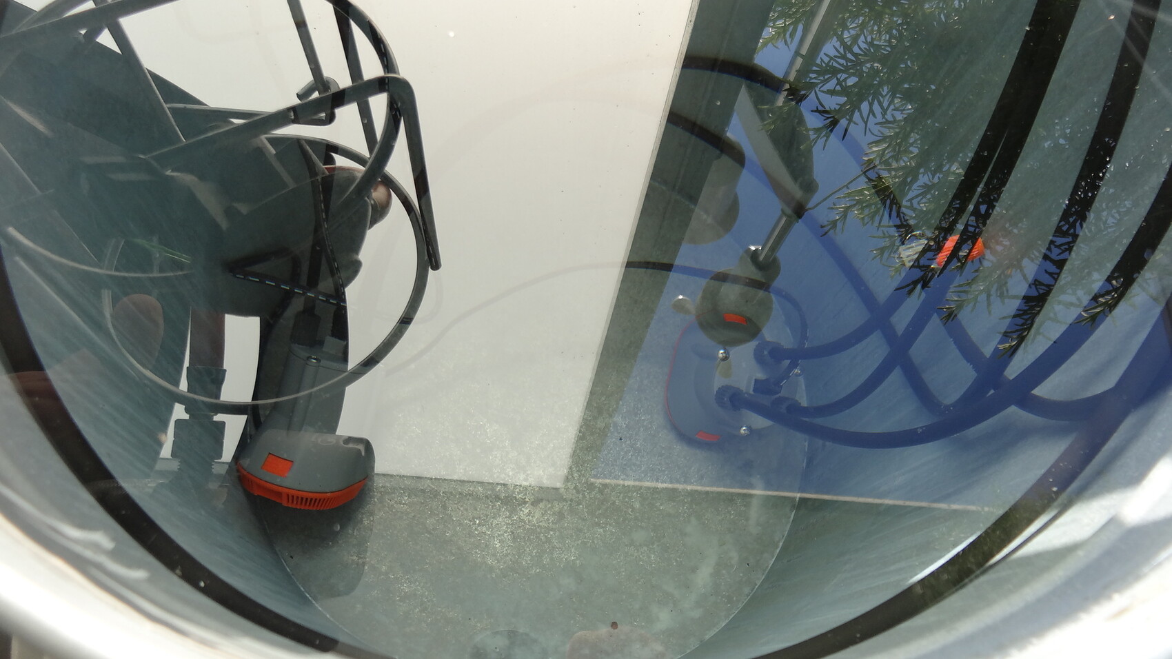

I purchased two of the Gardena balcony irrigation systems, which are actually designed for watering during vacation absences. I’m not interested in the included drippers, though. Additional materials I bought: much more than the supplied 10 m (30 feet) tubing (60 m (197 feet), but some was waste due to trial-and-error), several small bags of L- and T-connectors, and for each planter a 20 L/h (5.3 gallons/hour) nozzle.

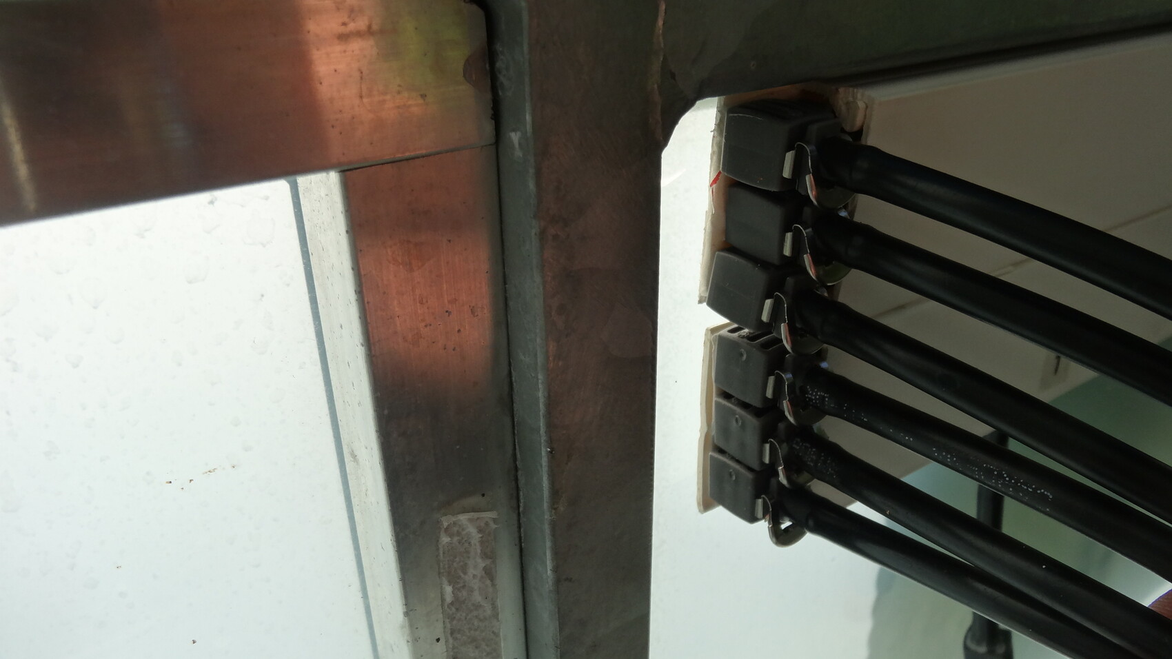

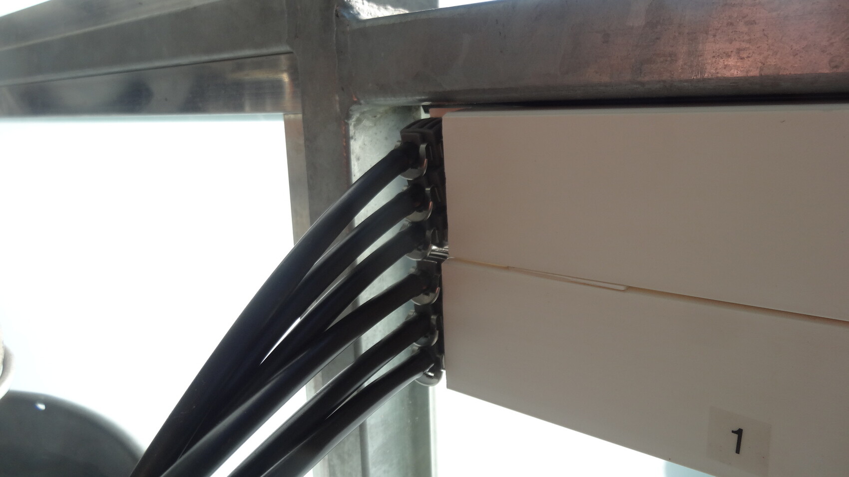

In total, there are six flexible PVC water pipes, each with a diameter of 4.6 mm (0.18 inches). They run from the water barrel through L-connectors into cable ducts from the hardware store. I bridge the vertical metal glass partitions with additional L-connectors.

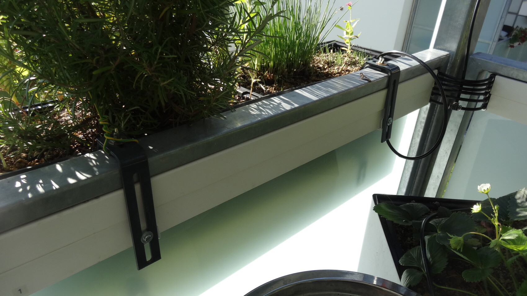

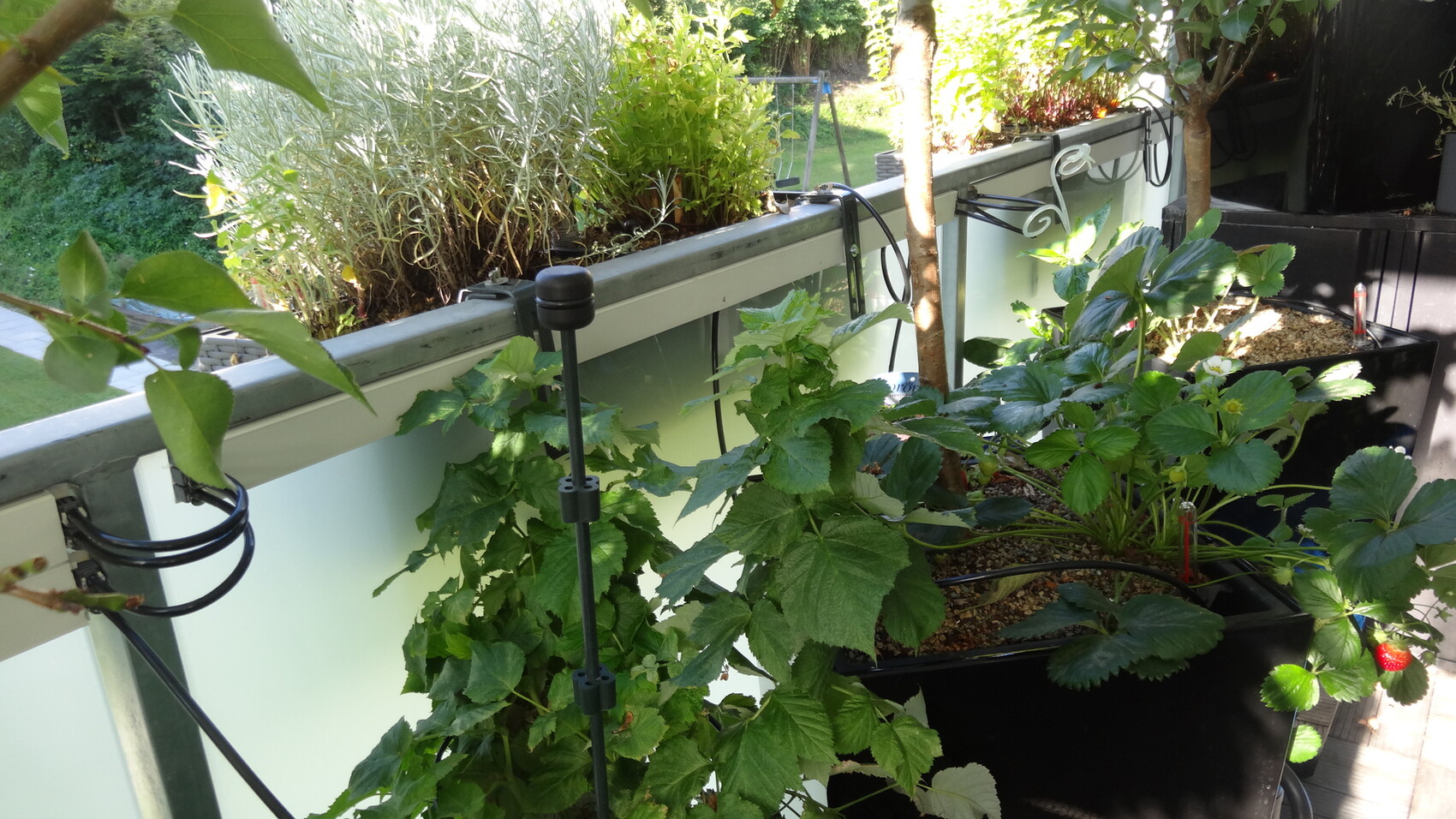

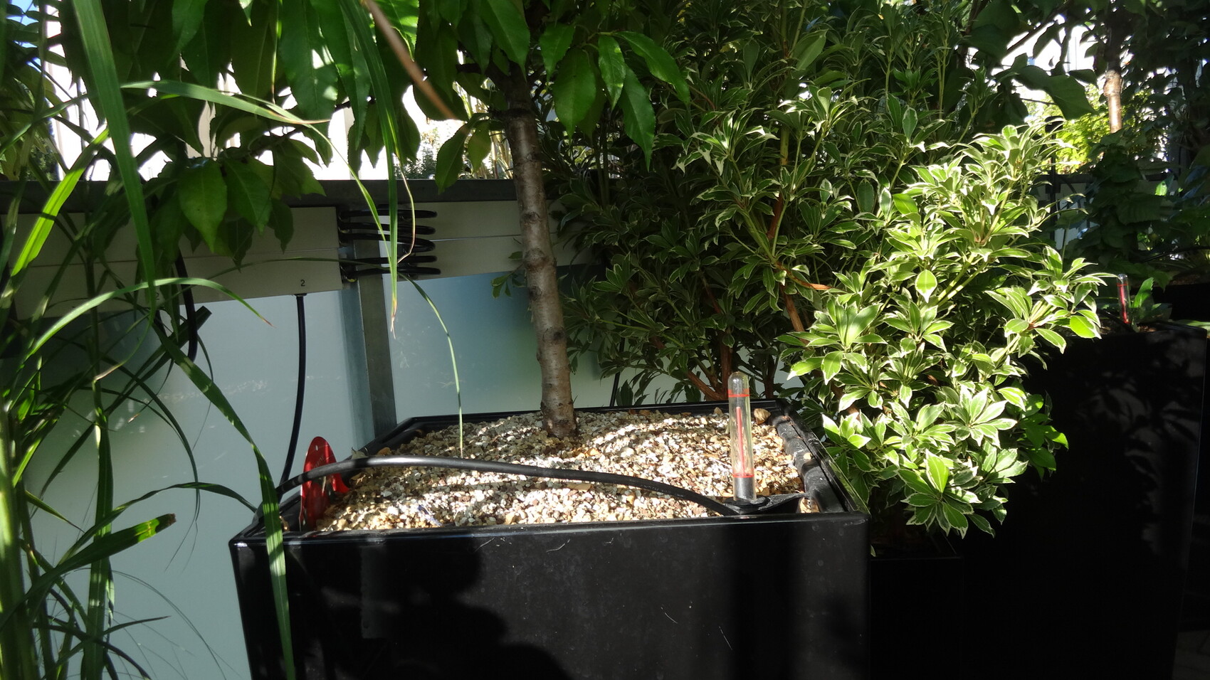

From the pipes, I branch off the water supply to the individual containers using T-connectors. It works very well — even the hanging planter receives more than enough water.
Tendentially, you water a bit too much (20 liters (5.3 gallons) flow through in just 3 minutes), but the Lechuza containers have an overflow system, so waterlogging cannot occur.
