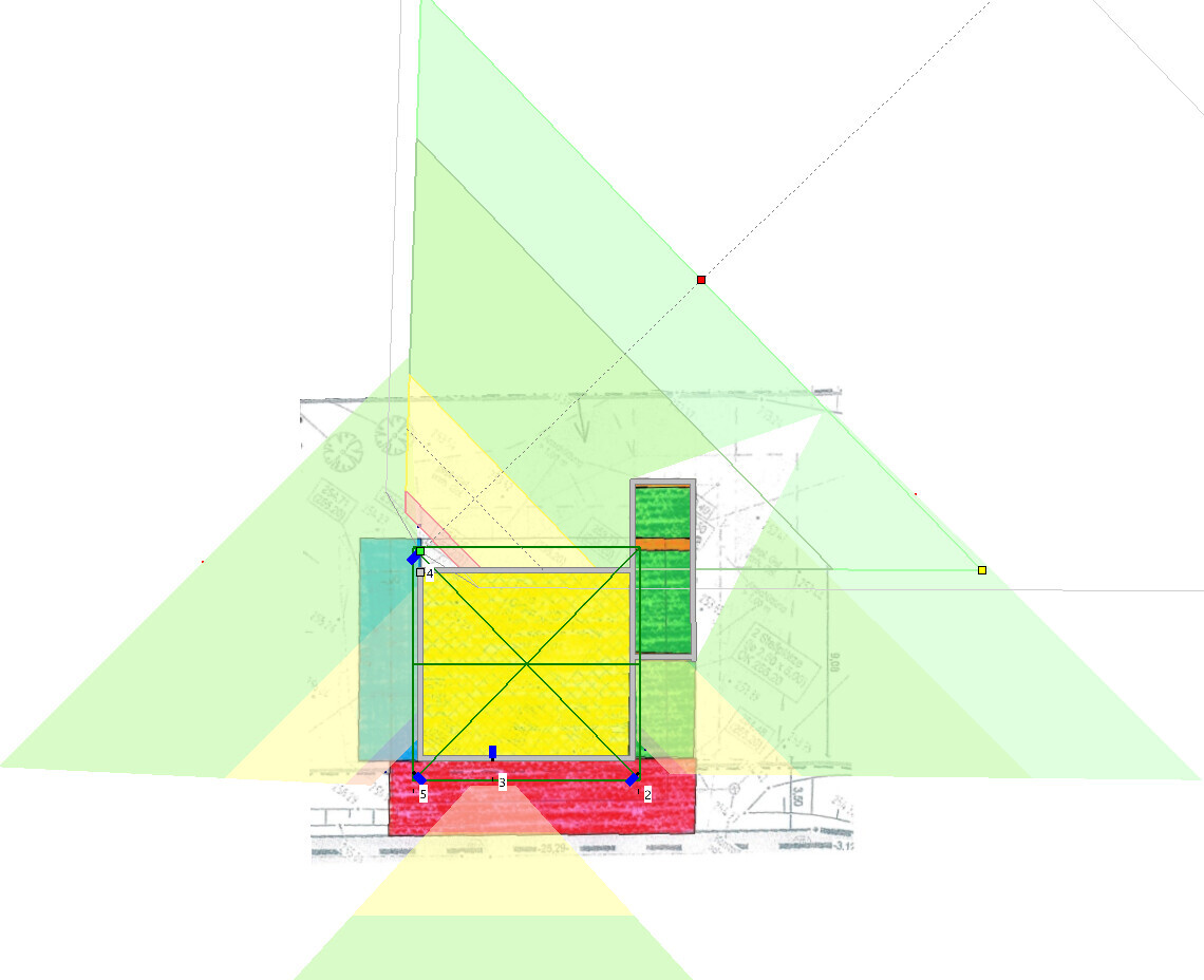

Better to plan for an outdoor (PoE) Wi-Fi access point from the start (Unifi?) -> laptop on the patio table / home office? Guest Wi-Fi outside, etc.Where would be the best place to position the access point?Here are my thoughts on the property for the cameras. At the front, the doorbell camera, then instead of just at NW and SE, a third camera on the SW side as well. This would cover most of the property.

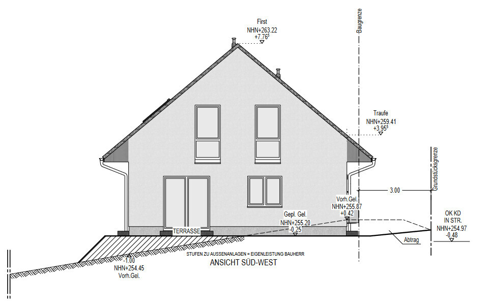

Here are my thoughts regarding the property for the cameras. At the front, the doorbell camera, then instead of only at the northwest and southeast corners, add a third camera at the southwest. That way, most of the property would be covered.
[ATTACH alt="planung-netzwerkschrank-und-heimserver-638793-1.png"]81374[/ATTACH]Also, consider what impact cameras might actually have for you. (Possibly a false sense of security; attracting the interest of thieves; maintenance effort and additional costs) Effective building security must be well planned and consistently implemented. Just having a network camera won’t achieve much. Just a small thought to keep in mind.

Take this as a small suggestion to think about. Thanks for the suggestion :-)
We have already had a consultation with the police and received advice on all components of the house, including the property’s lighting and also cameras.
