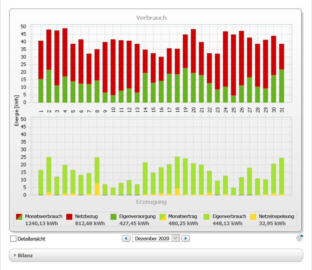

I only have the bidirectional meter, and my 9.9 kWp south-facing roof system generated 483 kWh in December, of which 358 kWh was fed into the grid. Where are you from? My 8.6 kWp south-facing roof in Nuremberg produced only 129 kWh in December. January is also looking weak so far with 83 kWh. The region is usually quite sunny, but this year the system is underperforming.

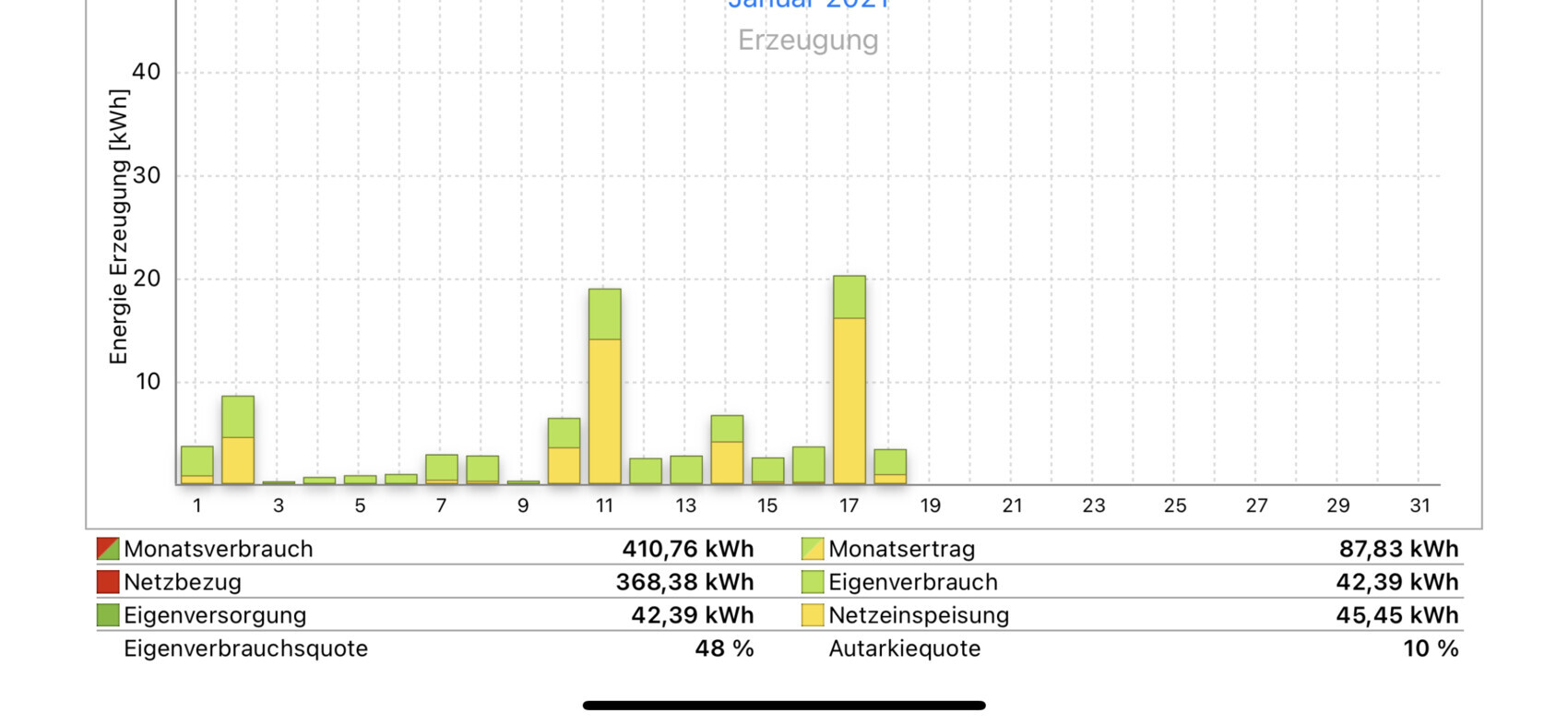

[ATTACH alt="IMG_7692.PNG"]56284[/ATTACH]You were really lucky with December. If PVGIS gives you 300 kWh, you are doing extremely well.So, it seems to be getting clearer. The solar technician also says that the consumption seems very high to him. It’s possible that the meter connections might have been swapped. They will check this tomorrow. However, the more likely reason for the extremely high consumption is that after the meter installation, we still used electric heating for the underfloor heating for a while—basically a temporary construction setup—because the heat pump could only be installed about two weeks later.
If that’s the case, then so be it. But at least we will know what happened.
