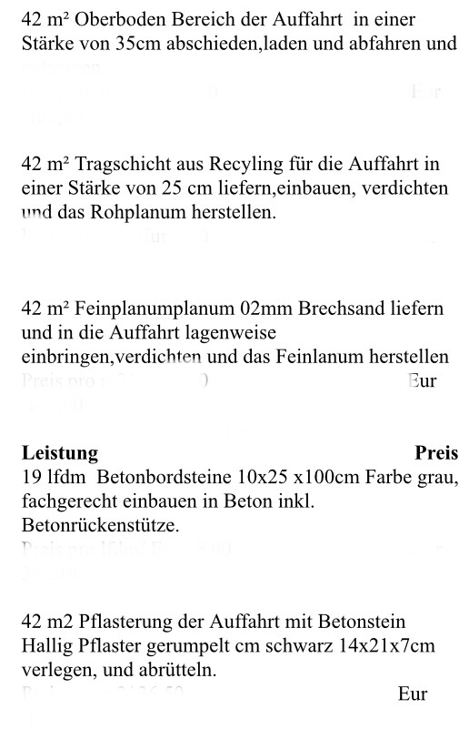

we recently had our driveway paved with natural stones. Unfortunately, I am not satisfied with the result. Many stones are still loose, and the surface is extremely uneven. We had a pathway paved with the same stones about 2 years ago, and that one turned out perfect.
I have already spoken with the builders, and we will find some kind of agreement. However, they are not professional landscapers but rather a general construction team that handles various tasks. (After 4 companies didn’t even submit a quote, we were just glad they finally agreed to do it.)
The main question is: How can I make the already laid stones as level and firm as possible? We are now trying to get a heavy (700 kg (1,540 lbs)) vibrating plate, as the previous one was too weak. Will that be enough to level everything properly?
