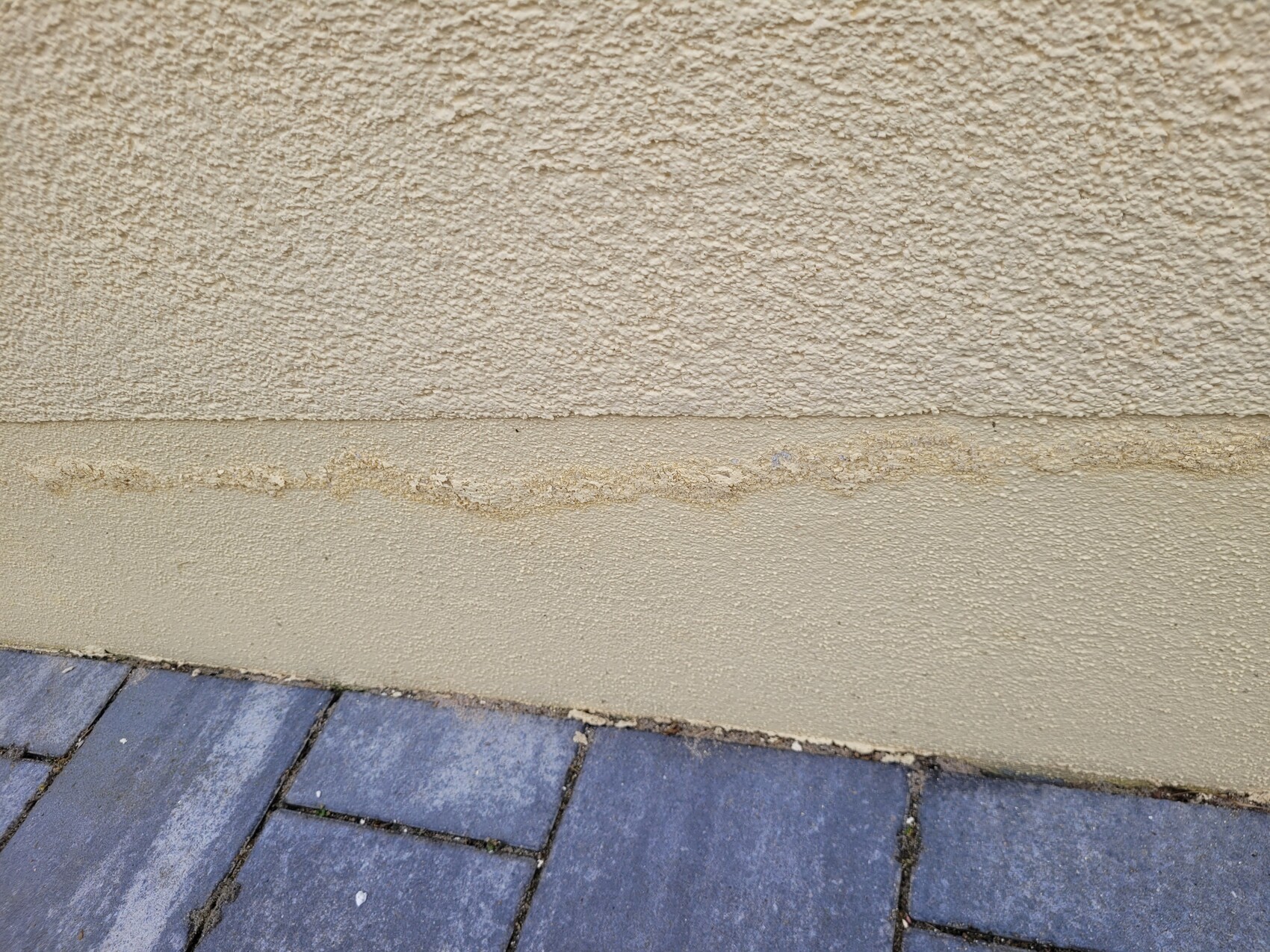

I have a problem at my house (5 years old) where the paint is peeling off at the base of the entrance area (see photo). Could someone possibly explain what kind of defect this is? Is it just a cosmetic issue or do I have a serious problem here?
For your information, during the first year after the paving was done, the pavement was mistakenly sloped towards the house. As a result, rainwater collected by the wall during heavy rain. This was later corrected and no longer occurs.
I really hope there is an affordable solution to fix this. Maybe some kind of primer?
I would appreciate it if you could help me.

Nice-Nofret3 Mar 2025 20:10To me, it looks like a typical moisture damage.
blablub12343 Mar 2025 20:39Nice-Nofret schrieb:
To me, this looks like a typical moisture damage.Ok, thank you for your reply. How would you suggest solving this problem?
nordanney3 Mar 2025 20:52Nice-Nofret schrieb:
To me, this looks like a typical moisture damage. Yes, but...
blablub1234 schrieb:
In the first year after the paving was done, the pavement was mistakenly sloped towards the house. As a result, during heavy rain, water collected at the wall. This was corrected afterwards and no longer occurs. So it is moisture damage, but an old one.
A dimpled membrane has already been installed. That is fine as well.
Therefore, I still recommend scrubbing the area and repainting it. If the problem reoccurs and it is not due to incorrect slope, you will likely need to lift the paving, dig a little, and check the waterproofing on the wall or the plaster below the ground level (GOK).
