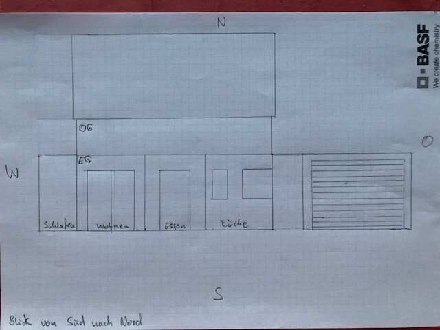

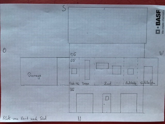

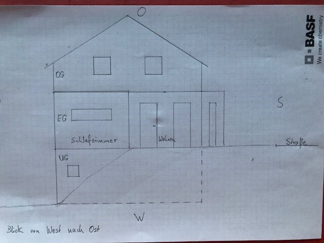

Standard design from the planner? We roughly sketched our idea and the architect fully revised it. Still without windows etc., as we have several fundamentally different floor plans.
Overall, we are satisfied with the floor plan.
We still have a few changes/questions:
- Possibly omitting the door to the kitchen to allow for a larger corner cupboard there, since we don’t have a pantry.
- Removing the windbreak area between garage and house. We want to keep the passage open for now.
- We currently have a dining corner bench and want to keep it. Therefore, we are considering installing a wall (only as high as the corner bench or kitchen counter) between the kitchen and the corner bench.

yes, great. I still think it’s good. The plot isn’t exactly my dream idea for a home. The garden faces the street and then slopes down into a dark void at the back. But you can make something out of anything, and for me, this would be a good option.
What’s crucial is how busy the road is.
