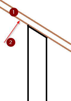

Now my calculation goes from the top edge of the base slab to the clear ceiling height (concrete ceiling) of the upper floor as 2.63m (8 feet 8 inches).
Plus upper floor concrete slab 0.24m (9.5 inches) + floor build-up upper floor 0.15m (6 inches) = 3.02m (10 feet).
The 4.6m (15 feet) is measured outside (hence the bold marking).
With a 48° pitched roof, this height rises inward.
So there’s a bit of angle calculation involved (I’ll spare you the details but included a picture).
I am assuming 0.36m (14 inches) for the outer roof tiles.
Back to the 3.02m (10 feet). There is a shortfall of about 1.6m (5 feet 3 inches) to reach 4.6m (15 feet) outside.
Plus 0.4m (16 inches) (see picture) = 2.0m (6 feet 7 inches).
What value is usually assumed for the ceiling build-up? I am currently assuming 0.15m (6 inches).
Does that mean from the bottom edge of the upper floor slab to the roof slope it is 1.85m (6 feet 1 inch)?
Or did I miscalculate somewhere?
Thanks a lot!
Thanks a lot!

WilhelmRo schrieb:
Or did I miscalculate somewhere? I don’t know which insulation material you want to use, but with standard mineral wool insulation at a thermal conductivity of 0.035 W/(m·K), you already need 20cm (8 inches) thickness. Adding battens, counter battens, and roof tiles, you end up with about 30cm (12 inches) in total thickness. Taking into account the saved angular calculation, you have to subtract about 45cm (18 inches), leaving 1.55m (5 feet 1 inch).
