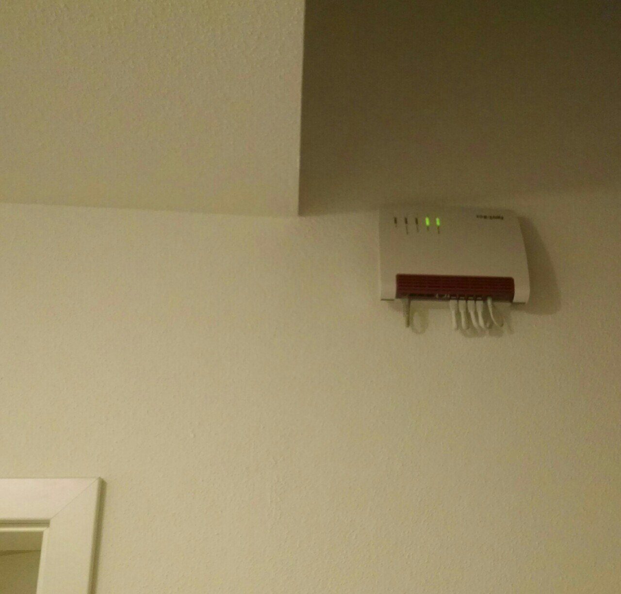

@11ant: Honestly, what you’re saying doesn’t make sense. We used conduit from Fränkische, not something cheap. And? Network signals like Ethernet and satellite only pass through moderately. Anyone who thinks they are replaceable despite the conduit is also believing in unicorns [emoji882]
And having a Fritz Box visible in the living area... absolutely not acceptable.
