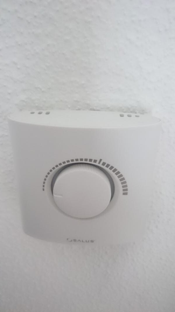

Best regards, Erik from moderne.HeizungHello.
Thank you for your reply.
I have now taken a photo of my heat meter inside the underfloor distribution cabinet.
It is not showing any readings! This surprises me.
I live in a building with six apartments. The heating system (pellets and collectors) is running.
The heating controller switches on when I turn it all the way to the left.
However, the meter shows nothing. It should be displaying something since the underfloor heating has been running during the construction phase.
Should I raise this issue with the developer? Or with the heating installer? Or is it normal that it shows nothing?
Thank you
Sebastian791 Aug 2016 09:44Have you tried pressing the keys?
