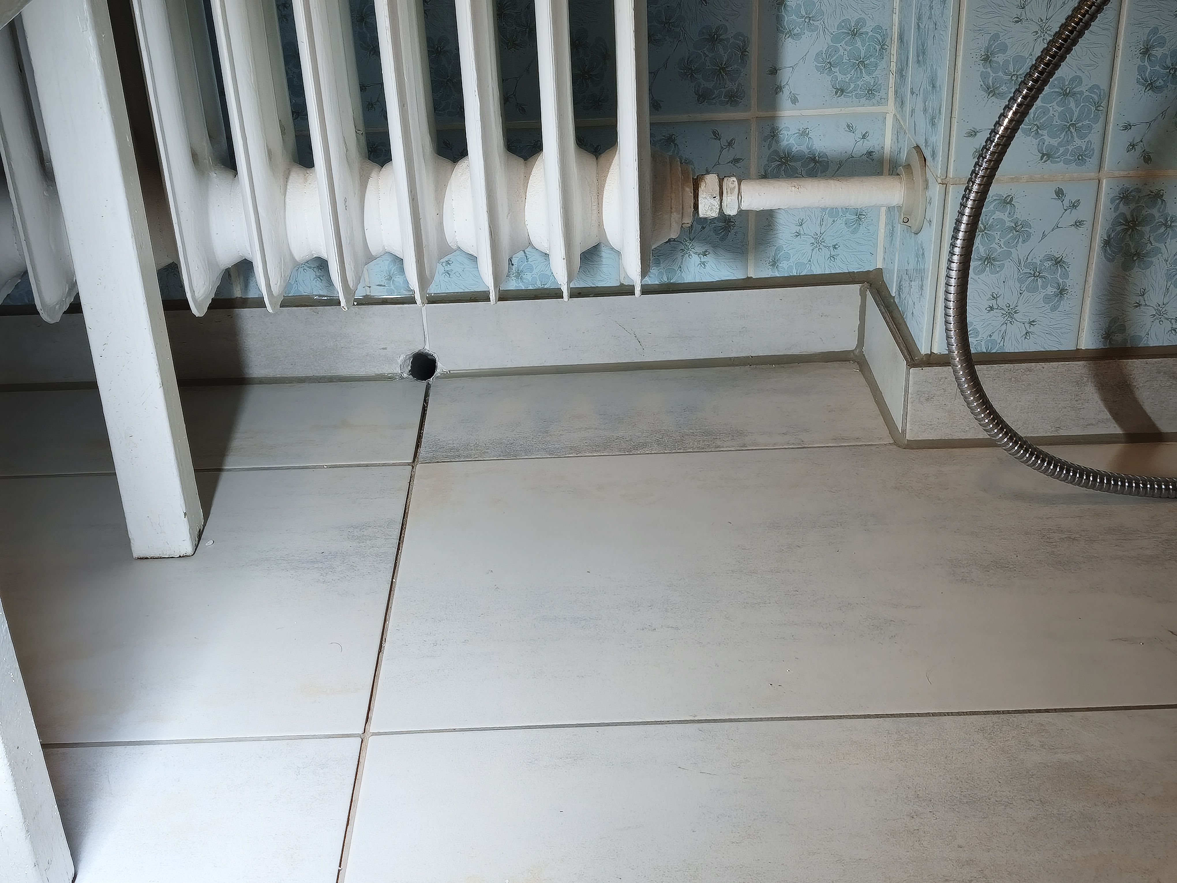

Hausbau4227 May 2026 02:07Here is my report ;-)
The roughly 24mm (1 inch) pipe – at least drilled freely and sealed again with waterproof joint mortar.
Will it make a difference? We’ll see... Probably (considering the effort versus benefit) a thicker pipe is usually more effective.
Maybe I can manage with a 32mm (1 1/4 inch) – or even better 40mm (1 1/2 inch) diameter pipe – on the house facade after all...
