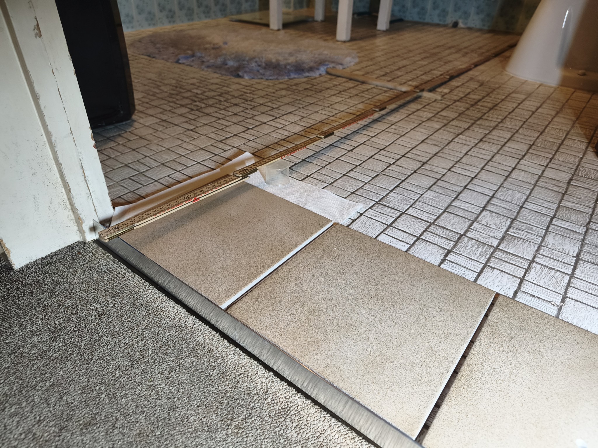

I have been advised several times to install new floor tiles with a slight slope toward the drain.
For my project, I definitely need to plan for a height difference of at least about 3 cm (1¼ inches) over a length of 180 cm (6 feet).
It would probably be much easier to lay the new tiles over the old ones. However, this would create a rather high threshold at the door. I will have to deal with some kind of threshold anyway.
If I remove the old tiles, how much lowering should I expect?
What would you recommend?

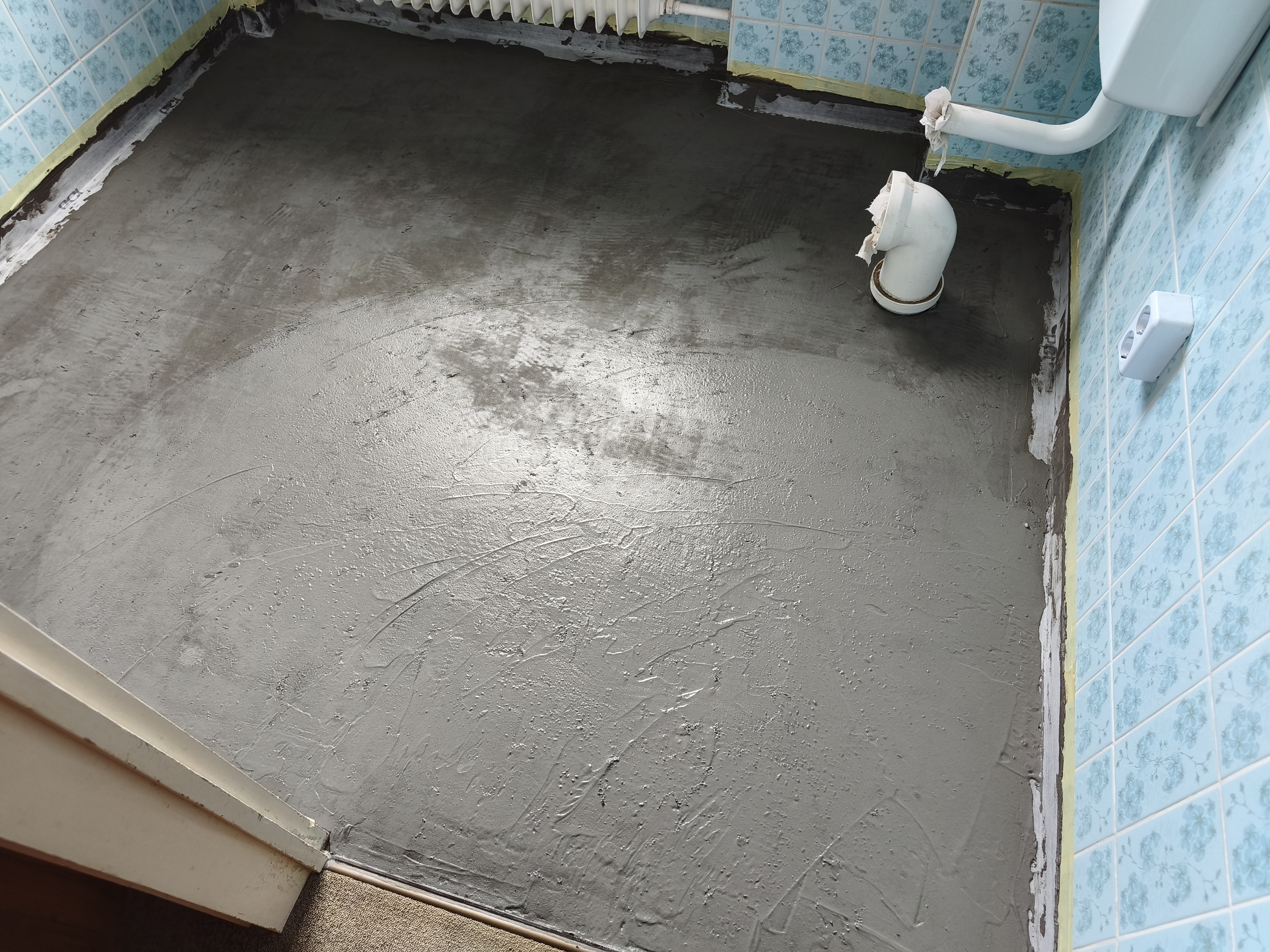

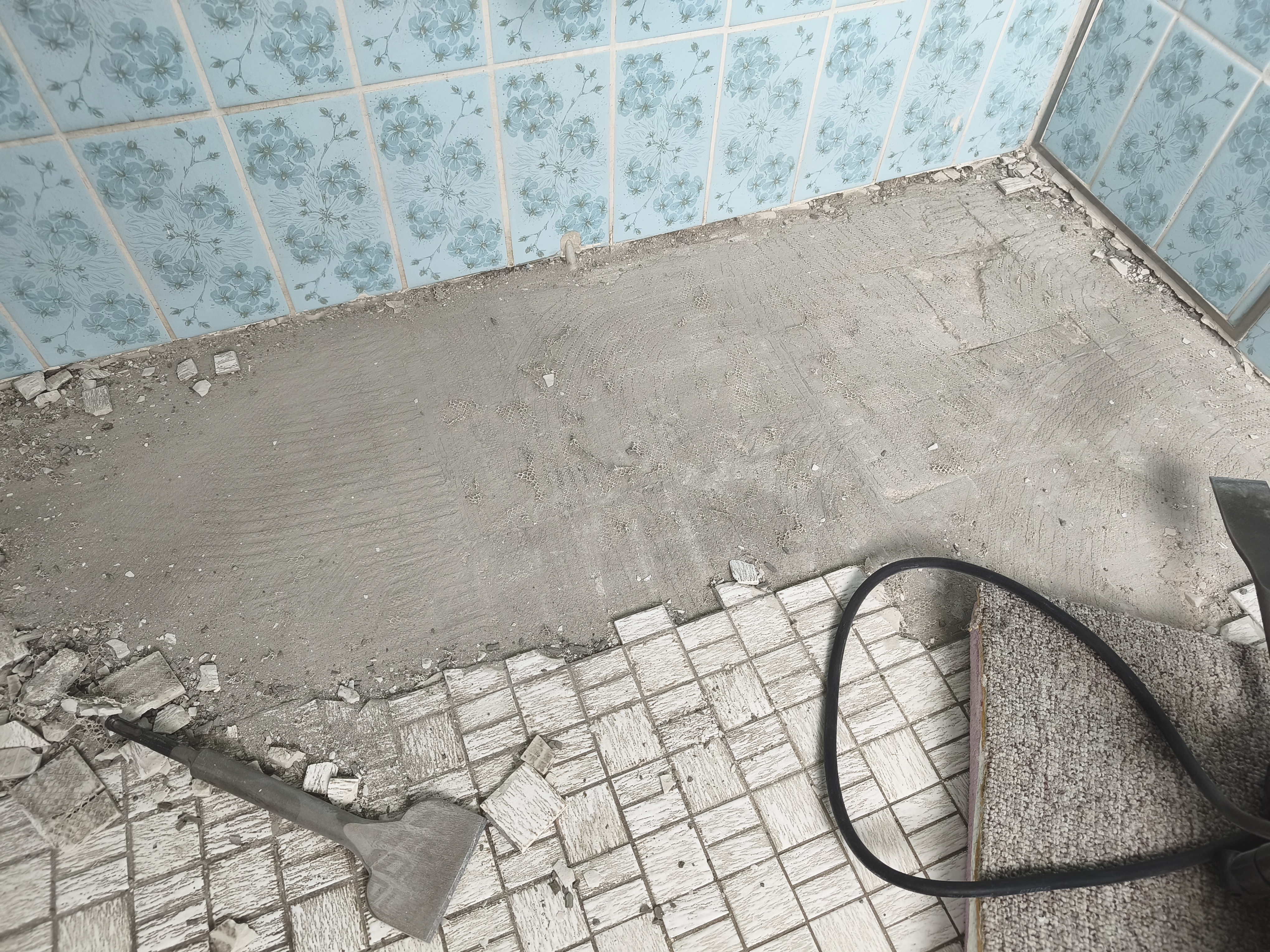

Hausbau4220 May 2026 22:54It ended up being 1 cm (0.4 inches) less – the tiles were removed. All those small mosaic pieces individually... Below that is the Styrofoam insulation and the reinforced concrete.
It doesn’t make much sense to install anything here (shower channel, floor drain, etc.). So the slope goes toward the drain under the window. Today is for waterproofing first. Tiles tomorrow.
