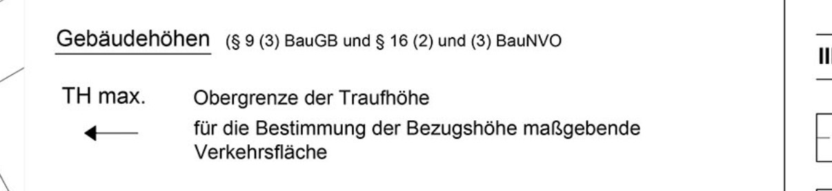

My partner and I have purchased a plot of land and would like to build a single-family house with a garage on it. We are currently looking for potential partners for the construction project. We have each had an initial introductory meeting with a general contractor, a construction management company, and an architect. Preliminary floor plan proposals will follow in the coming weeks.
We are posting in this forum to get helpful tips, opinions, and an assessment (feasibility, costs, etc.) for our building project. This forum has already been very helpful regarding basement regulations, slope assessment, and more.

No floor plan available yet. Here is an excerpt from the development plan, cross-section, and two initial ideas for the placement of the house and garage.
