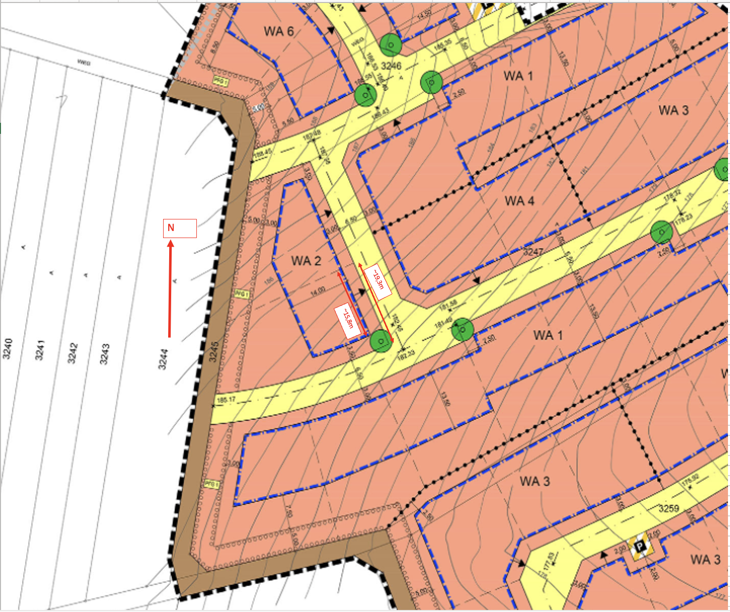

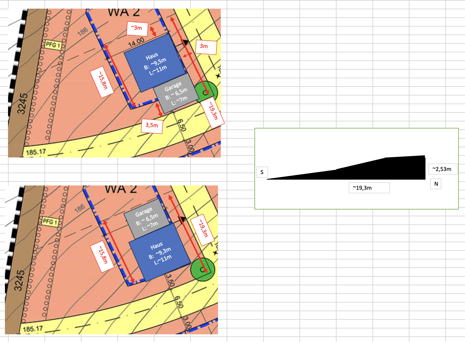

No floor plan available yet. Here is an excerpt from the development plan, cross-section, and two initial ideas for the placement of the house and garage.

Regarding reference height, the following is stated in the development plan:
“Reference height (§ 9 para. 3 Building Code and § 18 para. 1 Land Use Ordinance)
The reference heights for the fixed building heights are the adjacent street heights (elevations of public traffic areas). If the property borders several public traffic areas, the traffic area marked on the plan is decisive. Street heights are recorded in meters above sea level on the plan and interpolated if necessary. The building center point is decisive.”
Does this mean that a possible house placed in the north, depending on the width, may have the ground floor at approximately 184m (604 ft) elevation?
184m corresponds roughly to the street height in this area. As far as I interpret the plan, I would assume: The building may have a maximum eave height of 7 meters (23 ft) above the level of the east street (marked on the plan) relative to the building center point.

For an effective three-story house of that size, I’m afraid it will be too tight. Especially since it’s not really necessary for just two people.
Schwalbe12 schrieb:
We currently find it difficult to accept a bungalow with a basement/lower ground floor. Try to avoid labeling floors or houses. There is no legal definition of "bungalow," "town villa," or "architect-designed house."
The house is determined by the plot and your needs. Preconceived ideas won’t fit if the budget is limited and the building site is challenging.
Papierturm schrieb:
Sorry. Construction costs are brutal. The requirements are just as demanding.
Over 200sqm (2,150 sq ft) need to be effectively used by two people, so an additional basement makes little sense. Features like aluminum windows, large window fronts, and anything above standard size won’t fit the desired size and budget of 700,000€ (about $750,000).
However, I see a nice slope on the plot that could allow for a nice lower level.
If I were you, I would move away from standard house types and fixed square meters, and instead focus on spaciousness and quality.
For the slope, you should set aside about 100,000€ (about $107,000) just for foundation and earthworks. Personal preferences tend to be around 3,500€-3,800€/sqm (about $325-$355/sq ft). From that, you can calculate how many square meters are possible—and how many levels—making for a quick decision.
hanghaus202322 Jan 2026 16:40hanghaus2023 schrieb:
What do the arrows mean?They should indicate the access sides where vehicles are allowed to enter the property, especially if it borders two streets.
hanghaus202323 Jan 2026 12:07ypg schrieb:
These should be the access sides from where the property can be entered if it borders two streets.
ReportThanks, that could be. Is this specified anywhere in the zoning plan / building permit? I haven't come across it in this form before.
