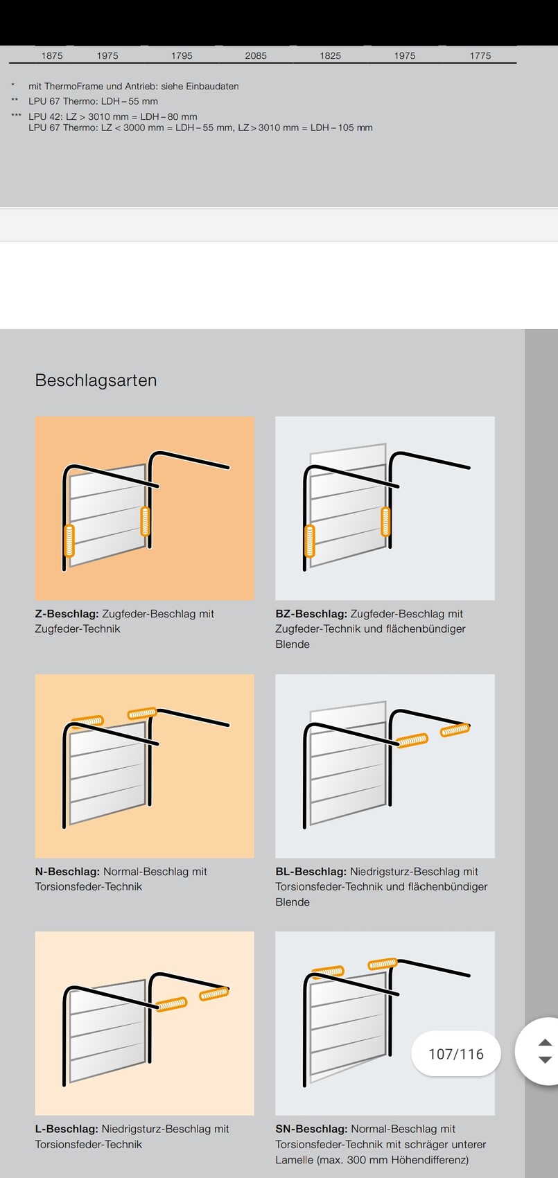

Hello, I am currently working on building a double garage. Now I need to find out how high the lintel for my garage door needs to be.
Door size 2.125m x 5.000m (7 ft 0 in x 16 ft 5 in)
I would appreciate any help.

Sebastian228422 Jun 2020 22:51Sorry, I meant the L-bracket... it only requires 11.5cm (4.5 inches) up to the ceiling.
In my case, the gate is installed just behind the facing brick, not behind the sand-lime brick.
So, there you have it.
2125 + 115
But as far as I remember, the L bracket is more expensive. Ask about it—you have it under control.
And 2.2 meters (7 ft 3 in) ceiling height is not that high either.

2125 + 115

Sebastian228422 Jun 2020 23:07My ceiling height is 2.55m (8 feet 4.5 inches). I only need the stop for the gate... send me a message, and then we can chat there.
