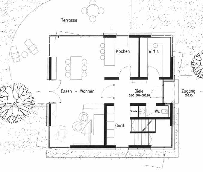

I believe we have created a good floor plan with the architect. I hope you can review the plans with fresh eyes to prevent me from overlooking possible issues. I also welcome ideas for bathroom and kitchen layouts.
With that, I now venture from quietly reading to stepping into the lion’s den. I will provide scaled plans with dimensions after receipt if desired.

Martial.white3 Sep 2020 12:44Here is the first draft from the architect.
In my initial post, the current version is shown after our requested changes were implemented.
Upper floor: Guest room removed, children’s room enlarged. Bathroom and master bedroom swapped.
Ground floor: Space for shoes and coat storage adjusted, utility room "removed," and kitchen planned around the corner windows.
