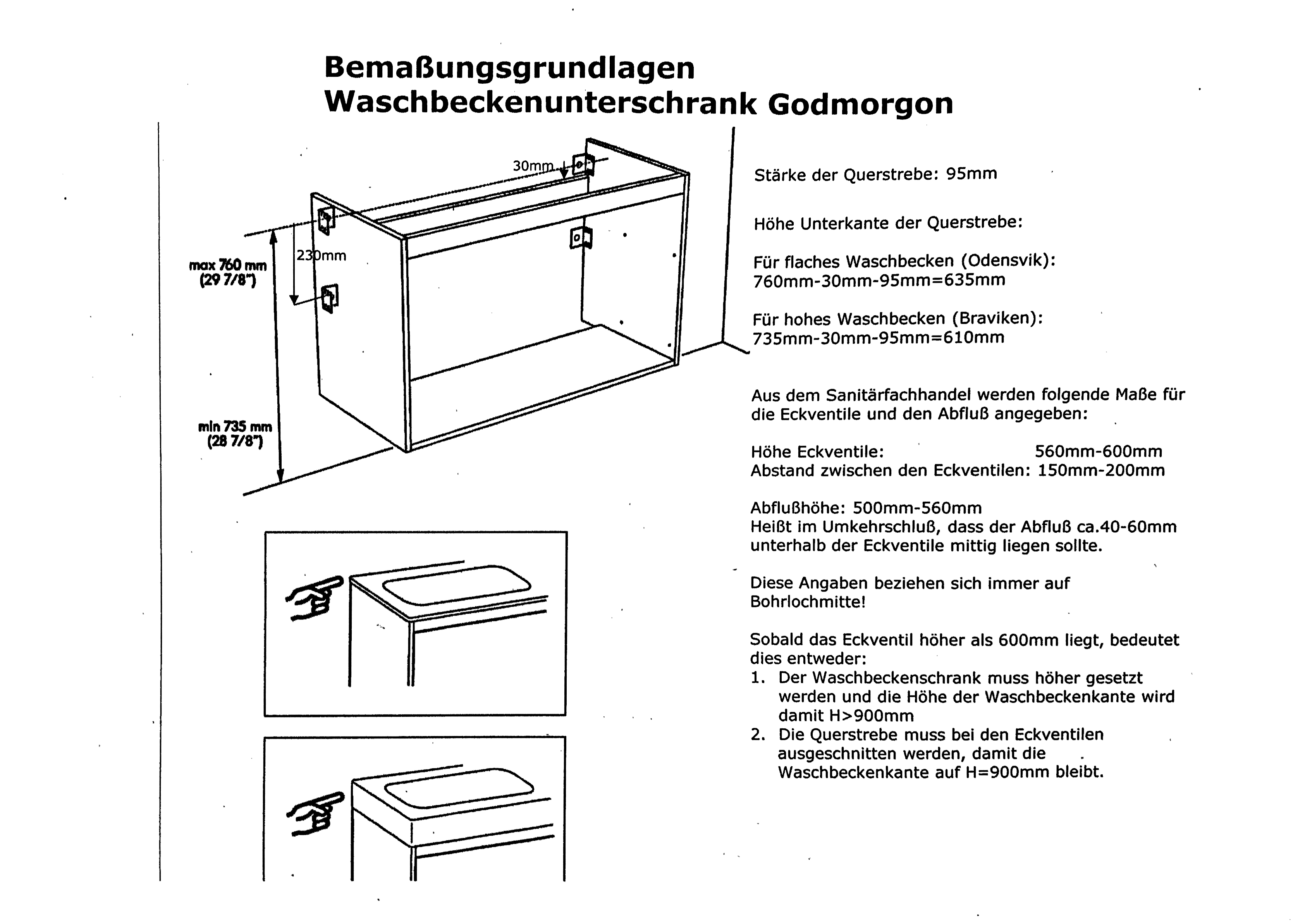

We went to Ikea yesterday. Unfortunately, they don’t provide a bathroom plan with connection details—that’s not a service they offer. Their planning tool doesn’t generate this kind of information either.
However, I did receive a sheet titled "Dimensioning basics for Godmorgon sink cabinet," which is helpful. With this, I should be able to create a plan myself. I’ve attached it in case it’s useful to someone else too.
