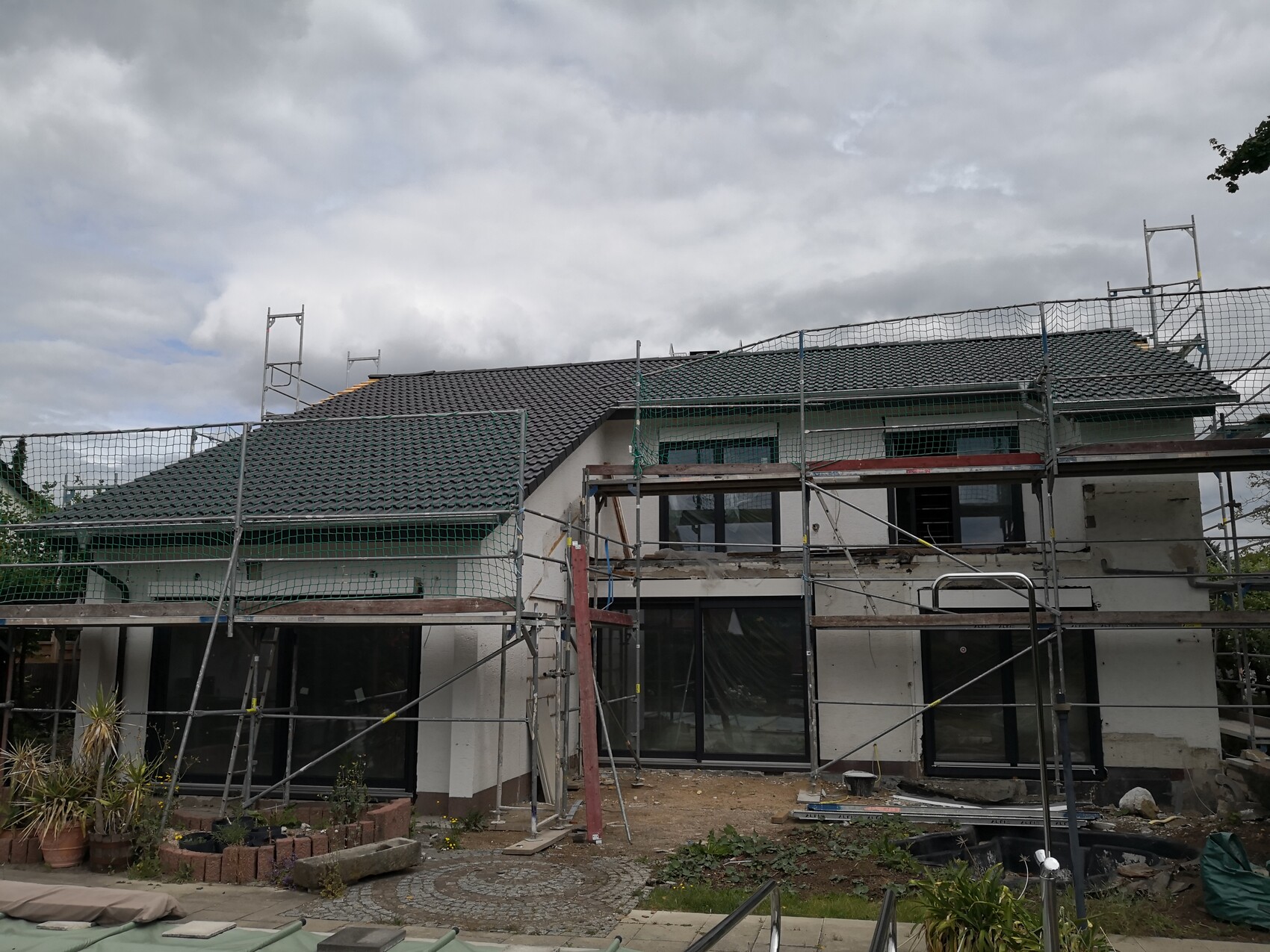

maybe someone can help me. I’m looking for a photo online to show our building contractor what I mean, but I haven’t had any luck and don’t really know what to search for.
Here’s the situation: Our roof is not continuous on one side because it steps back partly due to a balcony. The gutter on the set-back section is supposed to connect into the gutter of the longer section. At the moment, it’s set up like this (sorry for the not-so-great photo):
We just noticed this yesterday and haven’t had the chance to clarify if this is a temporary solution or the final setup. It definitely looks quite unattractive.

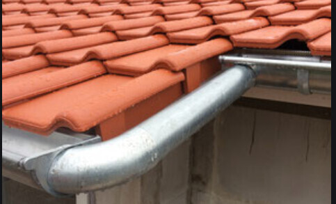

I’ve seen houses where the downpipe runs parallel to the roof slope from the upper gutter and then connects sideways into the lower gutter.
Maybe someone has something like this or knows what this kind of situation is called?
Pinky0301 schrieb:
that it is only a temporary solution for now. No, no, this is the final solution. The inlet funnel and everything else is already installed, and since it will be soldered, that is exactly how it is intended.
Mycraft schrieb:
everything is already installedThat was already installed before we discussed a solution... and it’s not a big problem to replace it anyway.Well, there is a detailed execution plan where the gutters and downpipes are usually marked.
And yes, of course, it’s no problem to replace anything. But replacing this and that, and before you know it, the workday is over. The roofer also has to be willing to cooperate in this.
hampshire12 Jul 2020 10:31Reinstall the gutter so that it slopes toward both sides of the roof. Lead the runoff from the gutter without a bulky funnel into a short pipe that goes over the first ridge of tiles and connects to the lower house gutter.
This looks better visually. In heavy rain, there might occasionally be an overload – so what, nothing will get damaged.
