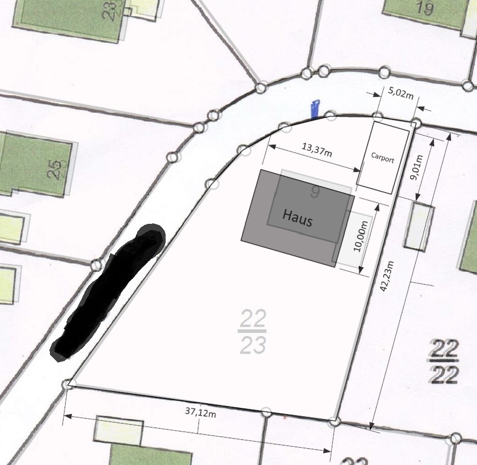

The area was filled in above. Good point about requesting photos, thank you. Attached is our site plan. In the background of the drawing, the old house can be seen with transparency. Without transparency is our planned house.
Site plan of a property: House with carport, plot 22/23, dimensions and outline.

7 Apr 2020 20:55
If the area has already been filled, I would conduct a plate load test. This way, you can verify whether proper compaction was done and not just the top centimeters.
