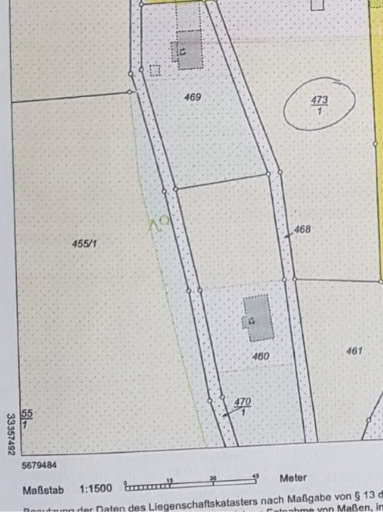

Today, the real estate agent gave me a cadastral map. The plot is surveyed and has a house on it. Here is the extract: the plot is 460.

The plot has been surveyed and there is a house on it. To me, this clearly looks like an area outside the built-up zone. Don’t let yourself be pressured, unless the land is so cheap that you would consider buying it as a recreational plot anyway. Maybe new construction is uncomplicated here, but I find it much more likely that the permitting authority will impose extensive requirements.

For me, it’s clearly an outdoor area. Don’t let yourself be pressured, unless the plot is so cheap that you would buy it just as a recreational lot. Maybe new construction is unproblematic, but I consider extensive requirements from the permitting authority much more likely.

One is quite far away. I see the building permit authority as the main obstacle to perfect luck here.The plot has a good price for the location, but only for recreational use, definitely not if we want to live there.
