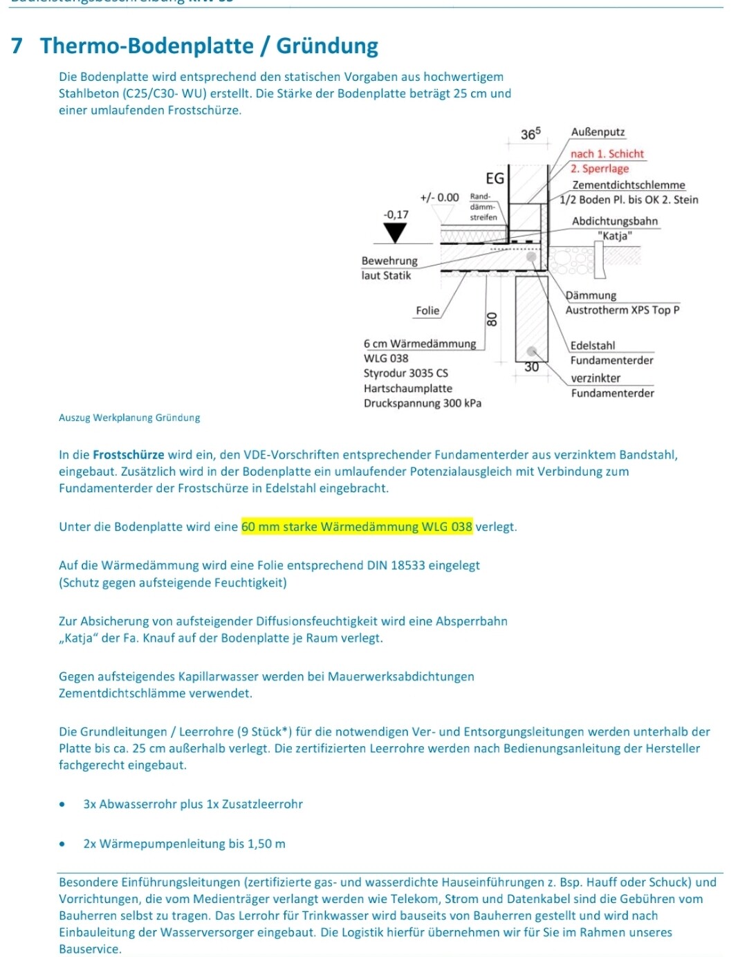

Here is the scope of work for our ground slab, so you have an example.
Construction drawing of a thermal ground slab with insulation and foundations.

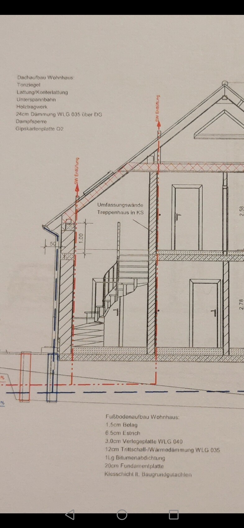

Here is the scope of work description for our foundation slab, so you have an example.
And here is the plan for my foundation slab. A solid 12cm (5 inches) thickness, at least!
Section drawing of a residential building: roof structure, stairwell, walls, doors, insulation.
