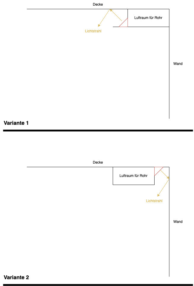

I would like to install indirect LED lighting in several rooms.
I am thinking of mounting a strip about 10cm (5 inches) below the ceiling.
The LED strip will be placed in this profile.
Attached is a picture showing roughly what I have in mind.
The transformer should also be hidden behind the panel.
Where there is a window, I would like to use the strip as a curtain rail as well.
Has anyone done something like this before?
What should I consider, and how can I mount the strip?

wiltshire19 Jul 2025 08:451. Choose high-quality electronics and LEDs. This does not have to be expensive.
2. Consider the power supply requirements regarding heat dissipation.
3. You can use any material you like for the strip cladding. It does not matter, as the lighting does not impose any special structural requirements. If you want something with a fastening system, check what types of curtain tracks are available that have a closed top. You can simply install it upside down.
