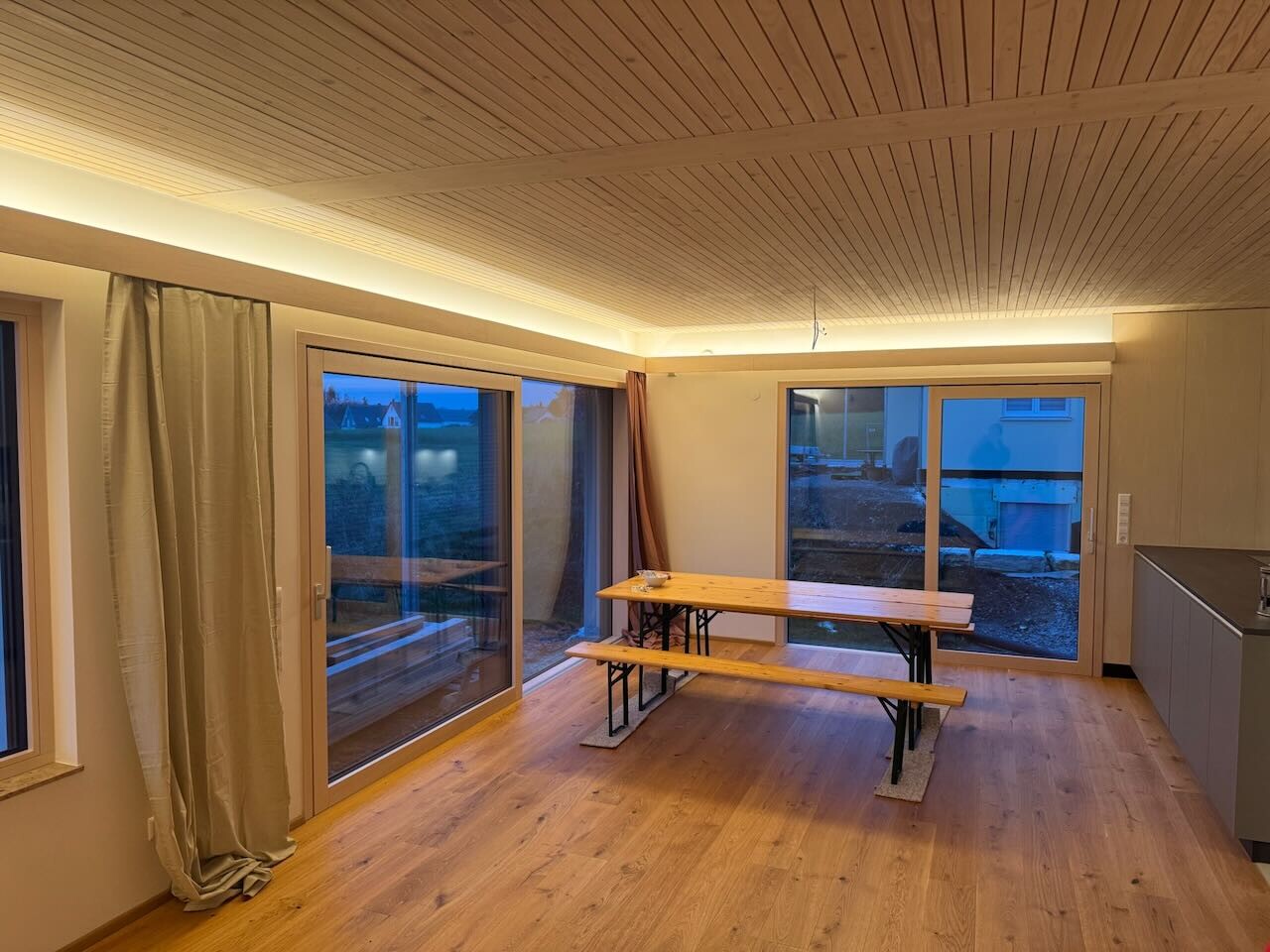

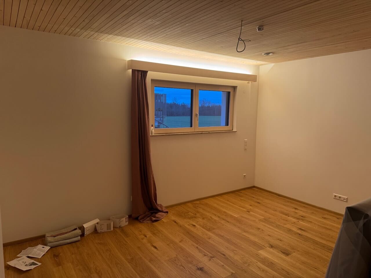

os24laenger18 Jul 2025 08:15Hi,
I implemented it exactly like this. For the mounting, I used the Vidga wall hooks and rail from IKEA. I screwed an aluminum profile onto the board on the back, which was then attached to the IKEA hooks. The COB LED strip is also mounted on this aluminum profile.
The power supply can be placed either behind the board or on top of the curtain rails; it’s best to use a dimmable one right from the start.

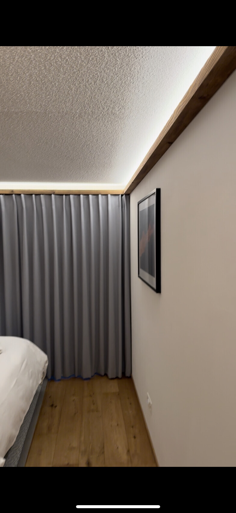

os24laenger schrieb:
Hi,
I implemented it exactly like that. For mounting, I used the Vidga wall hooks and rail from IKEA. I screwed an aluminum profile onto the board on the back, which I then attached to the IKEA hooks. The COB LED strip is also mounted on this aluminum profile.
Power supply either behind the board or on top of the curtain rails; it’s best to use a dimmable one.It looks nice. I want to use this lighting for almost all rooms.
Are there possibly other solutions where the strip/board is a bit thinner?
O
os24laenger19 Jul 2025 08:24I believe there is nothing standard off the shelf anyway, so you can saw the trims as thin or thick as you want.
