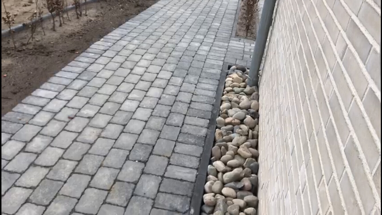

Ok, where you had the curb, the workers poured a kind of shoulder support made of screed concrete. It holds.
blaupuma11 Apr 2019 20:37
Nordlys schrieb:
Okay, where you have the curb, the workers poured a concrete shoulder support. It holds.
I also don’t have any curbs.
Only the eaves edge.
However, it is standard practice to install curbs.
Paved walkway made of gray paving stones next to a brick wall; gravel strip at the base.
seth048711 Apr 2019 21:35
It is also possible to do without curbstones if the side paving stones are set in concrete or have a backing support.
We are using a granite curb. This matches well with our granite posts, which accommodate the height difference to the adjacent public pathway.
