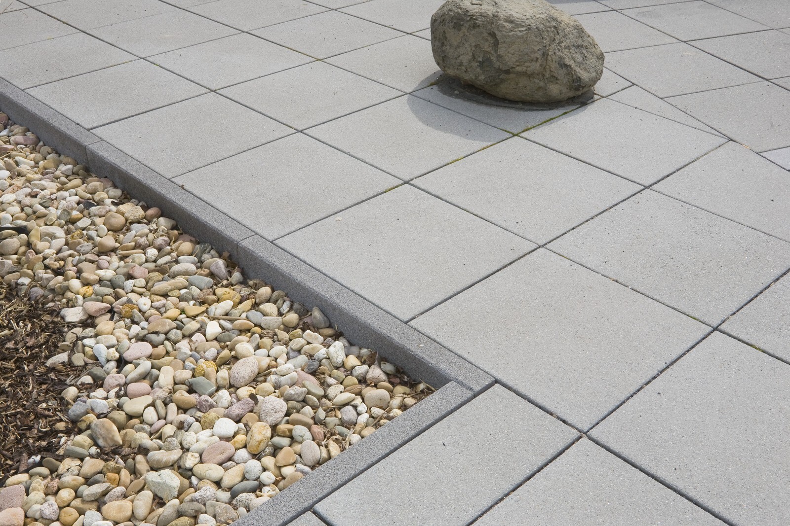

Curbstones are basically curbs. I’ve attached a photo.
My father is self-employed in this field and charges between 40€-50€ as labor. Material costs are additional. At the moment, he can almost roll the dice with prices. Sometimes he sells labor for up to 80€ per hour if it needs to be done quickly.
It really pays off to compare prices or to do some of the work yourself.
