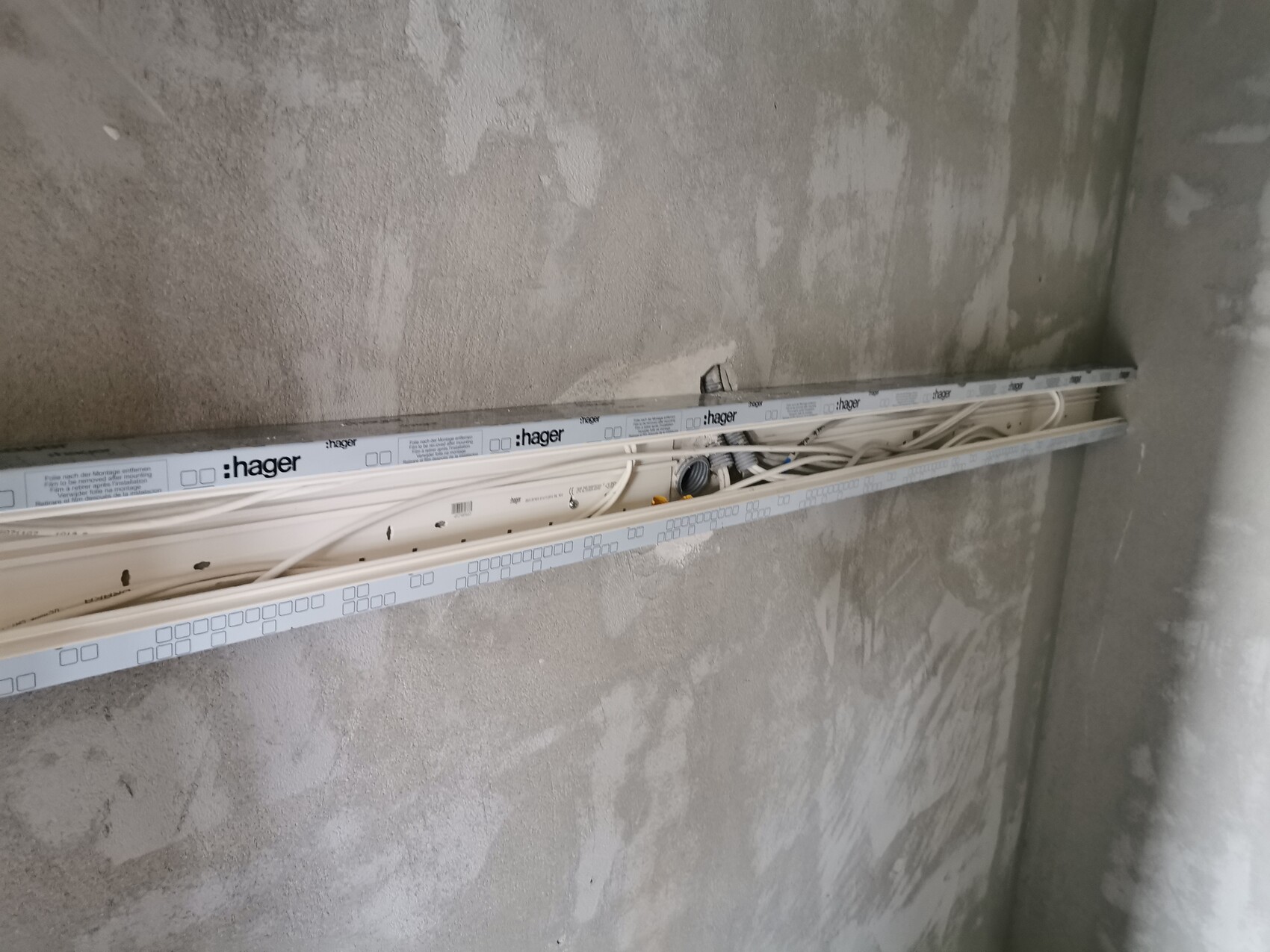

Try searching for the multimedia channel from Fränkische. We installed it ourselves. The wall is only opened where connections are needed, and the TV covers everything. We have a Samsung with an external connection box, so we access the wall in a minimally invasive way, so to speak. This way, only the TV hangs on the wall without any visible cables or inconvenient lower cabinet.
I think the version with the cable duct is the best.

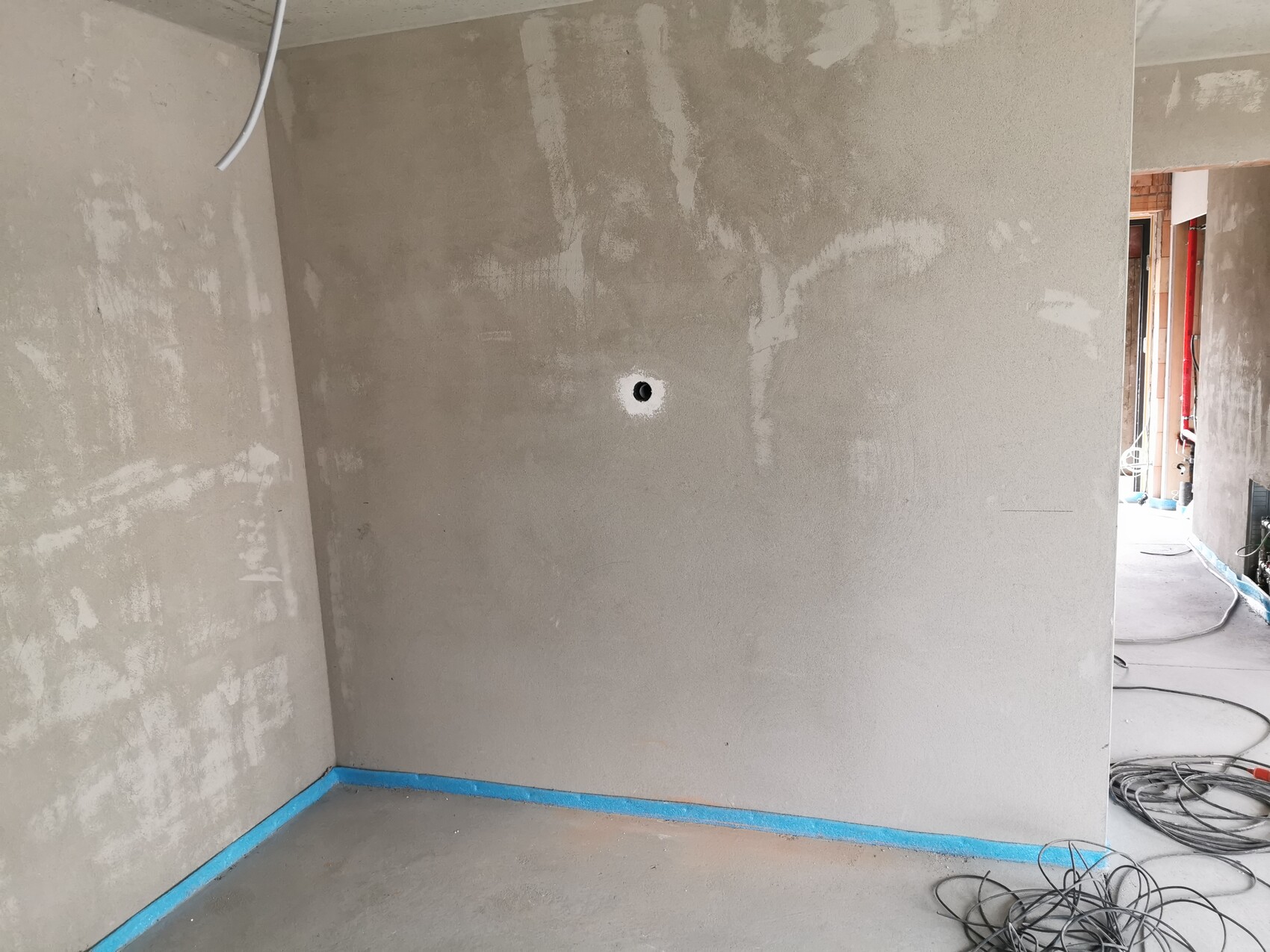

I have a question about the outlet though. What does it look like there? Is it just a hole in the wall, or do you install a frame for a clean edge? Or do people usually say it doesn’t matter since the TV will be in front anyway?
