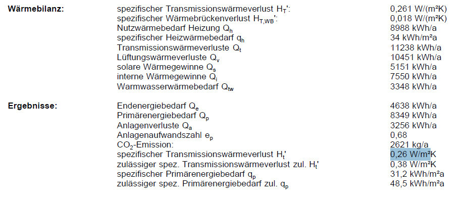

So... long story short.
I had the wrong documents.
The documents I had were only needed to submit the building permit / planning permission application.
This looks better now, doesn’t it?
After following up, I have now received new documents:
Energy rating scale from A+ to H; final energy demand 17.3 kWh/(m²a), primary energy demand 31.2 kWh/(m²a)
Table of the heat balance including transmission heat loss, heating, and CO2 emissions.

It really looks better. However, now I’m skeptical:
1. The client becomes suspicious and suddenly a better energy calculation is presented out of nowhere.
2. KfW55 standard is usually built to qualify for the KfW funding. However, this requires that the energy calculation is done and the KfW55 standard confirmed by the energy consultant before construction starts. This means the documents submitted for the building permit / planning permission couldn’t have been the final ones. Unless construction started right away, meeting the minimum standard of the Energy Saving Ordinance, and afterwards: surprise, it actually meets KfW55. But I find that unlikely.

Yes, the H’t value is better. From a distance, it seems to be planned exactly around the H’t value, not better. Effort was made to calculate the thermal bridges, possibly to save on expensive materials or insulation. However, it should be accurate! Most likely, several houses were planned simultaneously.
For context: we also have 0.026 listed in the energy certificate, but this includes a 0.05 thermal bridge allowance, so the real value is probably better. No one calculated the thermal bridges for us.
In the end, though, it’s not important. I think the insulation is sufficient; more insulation is rarely economical.
The values given in kWh/m2a (kWh per square meter per year) are based on the usable floor area, not the living area. The area should also be indicated somewhere in the calculations.
The heat pump should still be properly sized, and the hydraulics, especially the underfloor heating, should be well planned for very low consumption. But you already know this; on the other hand, you probably have no influence on it anymore. Possibly check later if valves or buffers can be removed again.
