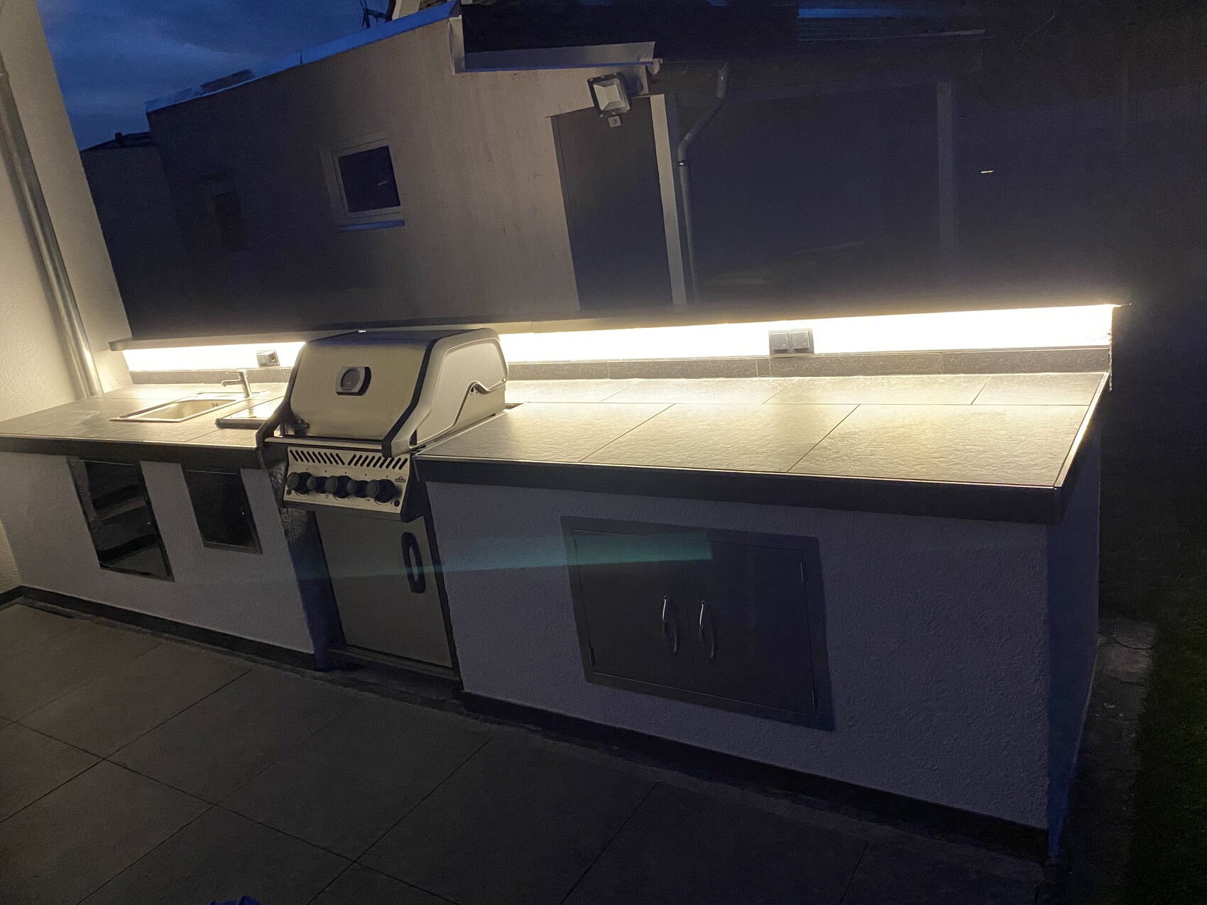

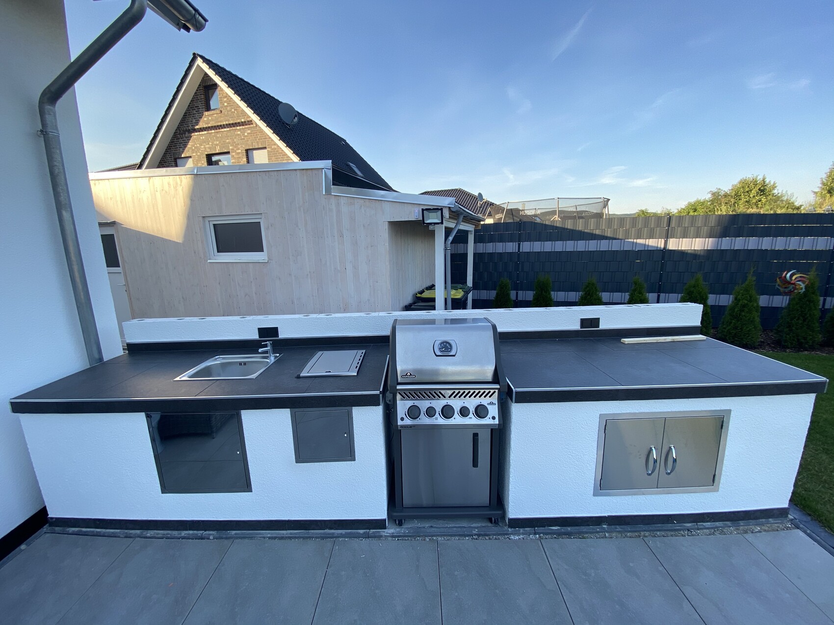

19 Jul 2020 12:37
I finished the kitchen the day before yesterday. Thanks again for your tips.
Outdoor kitchen with sink, grill, and cabinets on a gray countertop in the backyard.
Outdoor kitchen with built-in grill, sink, and cabinets at night; LED lighting.

Cool! Is there a refrigerator / fridge compartment behind the door on the right?
