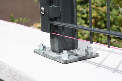

MirkoEhrens27 Oct 2021 14:37I assumed he meant the screws used to attach the base to the foundation, as shown in the picture (from the internet, not mine). RAL 7016 is anthracite. I’m not allowed to share links, but if you search for spray paint on Camas’s website, you will find the product I was referring to. If you’re reasonably skilled, you can paint with it so well that the difference becomes unnoticeable.

In my case, it looks like in the image linked above, with the bolts sticking out slightly less from the nuts. Even with caps, I don't think it looks very good, so I would prefer a cover for the entire base. Unfortunately, I can only find ones made of plastic...
