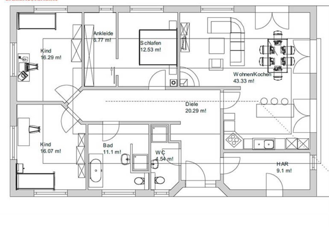

Please show the design on which the general contractor is basing the claim for an extra nine thousand dollars for two gables.
Sure, gladly...
However, I need to mention that so far, only a rough estimate without details has been sent by the company via email. There has been no personal meeting yet. The offer is initially based solely on my general information, such as the living area, etc. They basically used one of their standard designs as a basis for a “cost direction,” which in some parts is not entirely clear to me. That’s why the appointment for further questions was arranged.
