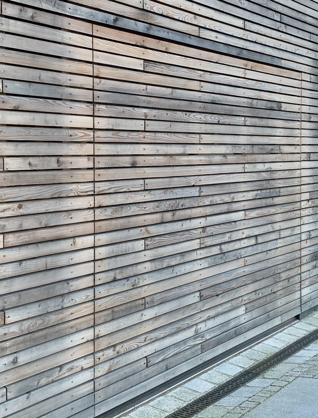

BobRoss
28 Jan 2024 10:53
Here is a flush-mounted garage door with rhombus-patterned wooden cladding. Hörmann industrial sectional doors ALR F42 were used.
Horizontal weathered wooden plank wall in front of a paved walkway with a drainage channel.
