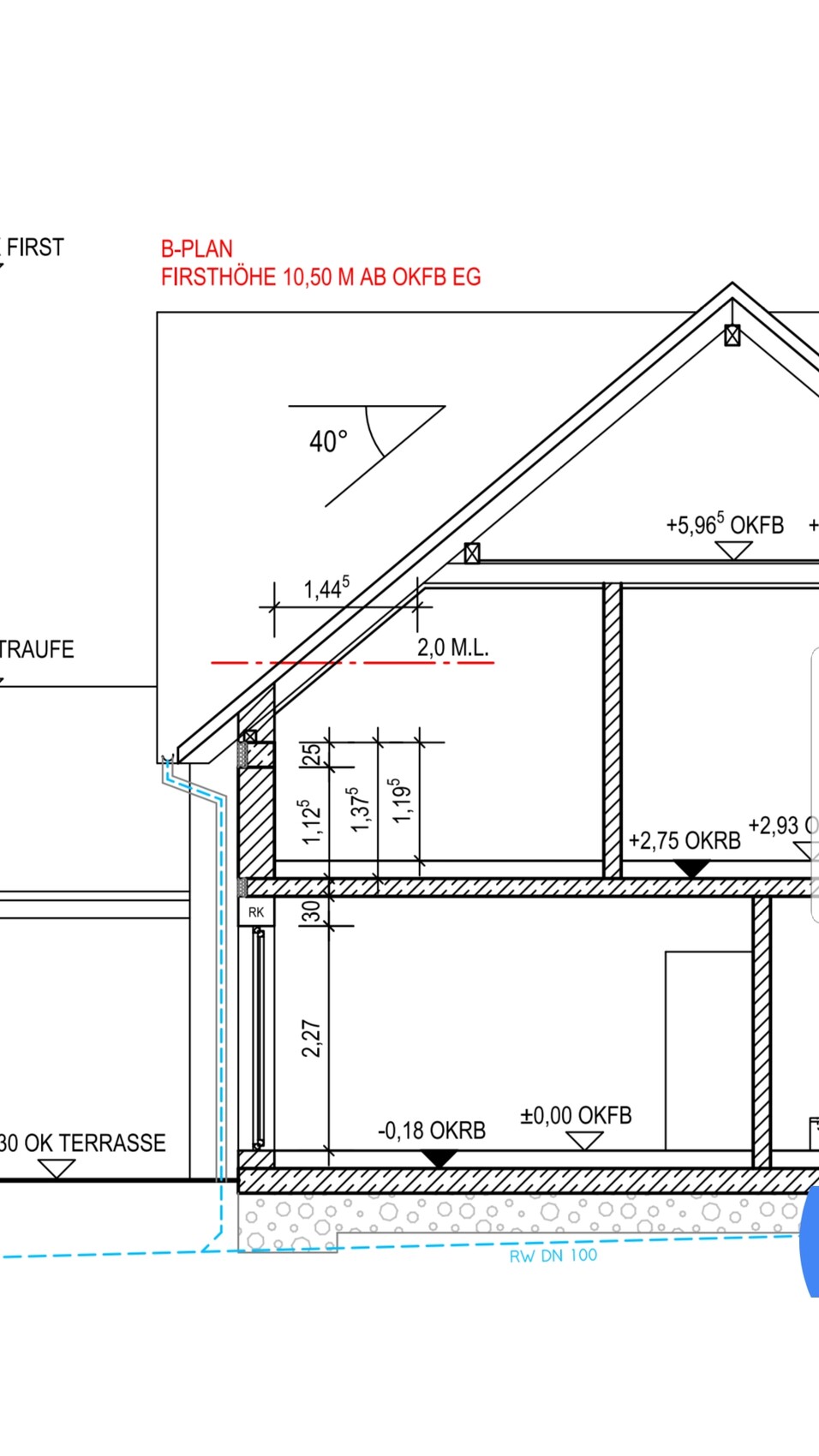

Josephine2489, what knee wall height do you actually have? It looks quite “intense” from the outside.
Best regardsWe had one row of bricks built extra high because my husband is 2.00 meters (6 ft 7 in) tall and wanted to be able to stand relatively comfortably upstairs. Overall, it works really well for us. :-)
Does the picture help? I think you can see the knee wall there!?
