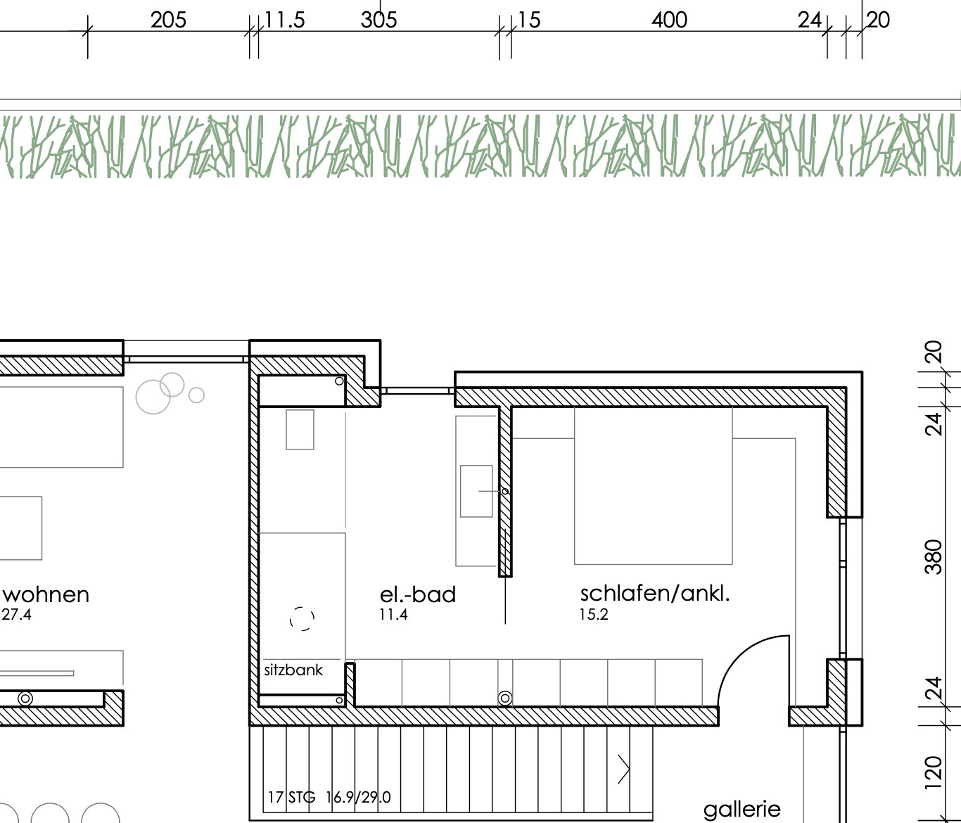

The section is dimensioned (underlying grid). DAnd you expect everyone here to read through all the text first to understand the grid? That everyone has to read all the text to figure out where each exit leads? These are all details that would be clearly visible at a glance with a properly dimensioned floor plan—without having to read through walls of text 😉. Of course, you have the plan in your head, but we don’t.D
derdietmar21 Sep 2021 20:58Hello,
to be honest, I really assume that interested readers will read the initial post 😉 But your point is valid, a dimensioned section is definitely helpful.
Here is the excerpt from the “real” plan with adjacent rooms. Please note that the offset on the north side is 40cm (16 inches).
Best regards!
Best regards!
derdietmar schrieb:
Here is the current planning status: I really like it very much. Just modern simplicity 😀
derdietmar schrieb:
And a version with a separate lockable shower room including toilet: That is too complicated in layout. It makes everything feel small and cramped.
derdietmar schrieb:
The second one is probably not quite our taste 😉 And why not? After all, you live inside and don’t look at it from above… is it too open for you? Too spacious? Too unique?
kbt09 schrieb:
Why is the entrance on the right side of the plan? Right side: window, bottom: hallway door, left: living room door...
