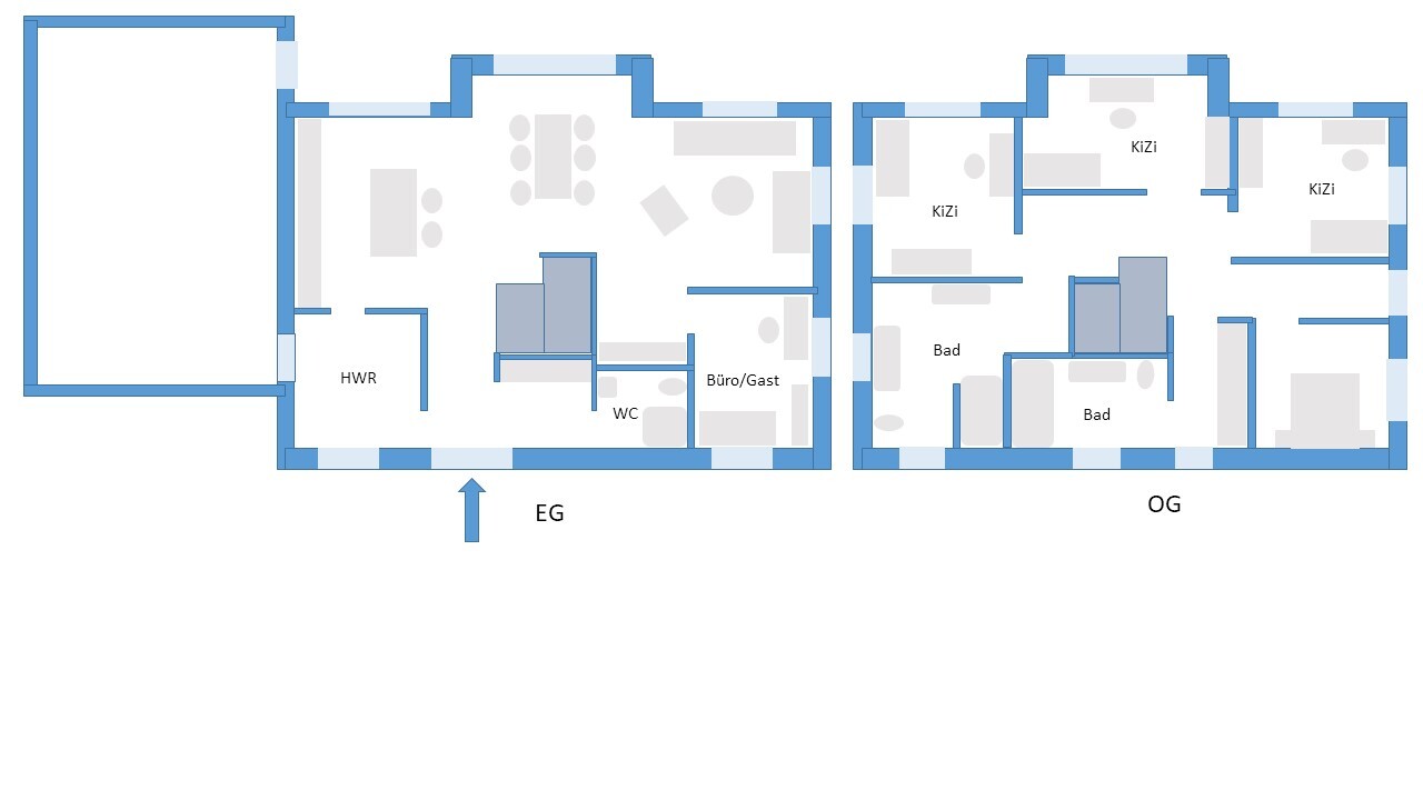

After a long wait, the first floor plan is ready. I would appreciate it if you could take a critical look and give me your feedback.
Plot size 643 sqm (7,000 sq ft)
Floor area ratio 0.30
Building window, building line and boundary
Edge development
Number of parking spaces 2
Number of floors 1
Roof type Gable roof
Architectural style
Orientation
Maximum height / limits FH 9.0 m (29.5 ft)
Other requirements
Homeowners’ Requirements
Style, roof shape, gable roof, four-gable
Basement, floors 1, no basement
Number of residents, ages 5 persons (34, 31, 7, 5, 1)
Space needs on ground floor and upper floor
Kitchen, living room, guest shower toilet, utility/technical room, smaller office/guest room
Number of overnight guests per year 10
Open or closed architecture partly open, partly closed
Conservative or modern design a healthy mix of both
Open kitchen with island, semi-open kitchen with island would be nice
Number of dining seats 6–8
Fireplace No
Music / stereo wall
Balcony, roof terrace
Garage, double garage
Useable garden, greenhouse Garden for pleasant evenings, children’s birthday parties, etc.
Other wishes / special features / daily routine, including reasons for preferences
We would like a larger but semi-open kitchen, as we cook and/or bake daily. The children also like to help in the kitchen.
If possible, I would also like an additional utility room on the upper floor, since all laundry-related tasks take place upstairs.
Who made the design:
– Planner from a construction company
What do you especially like? Why? Living/kitchen area is nicely large, lots of space for the family
Upstairs a beautiful large play hallway with additional storage space.
What don’t you like? Why?
Guest toilet door is somewhat awkward, too narrow? Hallway wastes too much space?? Where should a proper coatroom go? Entrance area is not appealing? The front door feels too small for the house, the guest toilet window does not fit visually. No idea how to improve this.
Price estimate according to architect/planner: still open / will follow once the floor plan and thus house size is fixed
Personal price limit for the house including fittings and fixtures:
Preferred heating system:
If You Have to Give Up, which details or extensions
– can you give up:
– can you not give up:
Upper floor looks good, entrance area could be better
Would a different staircase allow a better layout?
Thank you in advance

Alessandro19 Aug 2020 07:43From the outside, it can look really good, but somehow the wow factor is missing on the inside. It feels like a standard floor plan that was simply scaled up to 200m² (2,153 sq ft). Everything seems a bit too small, not to mention the lack of a wardrobe for 5 people!
Alessandro19 Aug 2020 10:18A
Alessandro19 Aug 2020 10:31If you shift the bathrooms a little, there is plenty of space here to fit a washing machine and a dryer:
