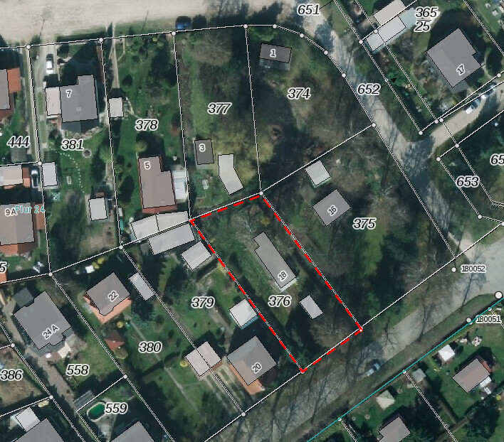

Lein.Manor3 Aug 2015 23:11These are the two plots of land (images oriented to north)
Dimensions: N, E, S, W
Plot 1 – approx. 922 sqm (Image: 22.49.29):
41m (135 ft), 24m (79 ft), 43m (141 ft), 20m (66 ft)
-> No developer involvement: Unfortunately, it ended again in a tenant bidding process. Tomorrow we should get the information whether we have it or not.

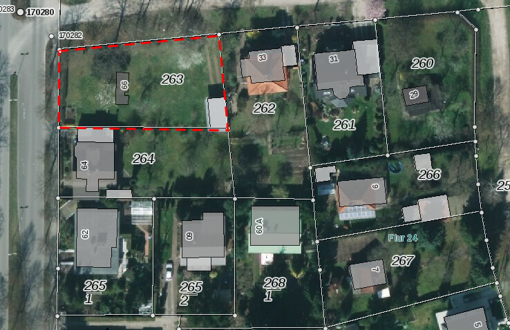

Plot 2 – approx. 804 sqm (Image: 22.50.37):
19m (62 ft), 42m (138 ft), 18m (59 ft), 46m (151 ft)
-> Developer tied: After the first more detailed conversation on Saturday, it was clear that we do not want to build with that company. We’ll have to see if we can get it elsewhere at all.
Basically, we have now given up the idea of a traditional developer. We have had talks with several companies, but none of them made us feel properly advised.
Today we met with a local building planner / architect, and they are now designing a house for us on Plot 1.
They mainly build in this town, have an excellent reputation, and we immediately felt comfortable with them.
Now we are naturally curious to see the results.
