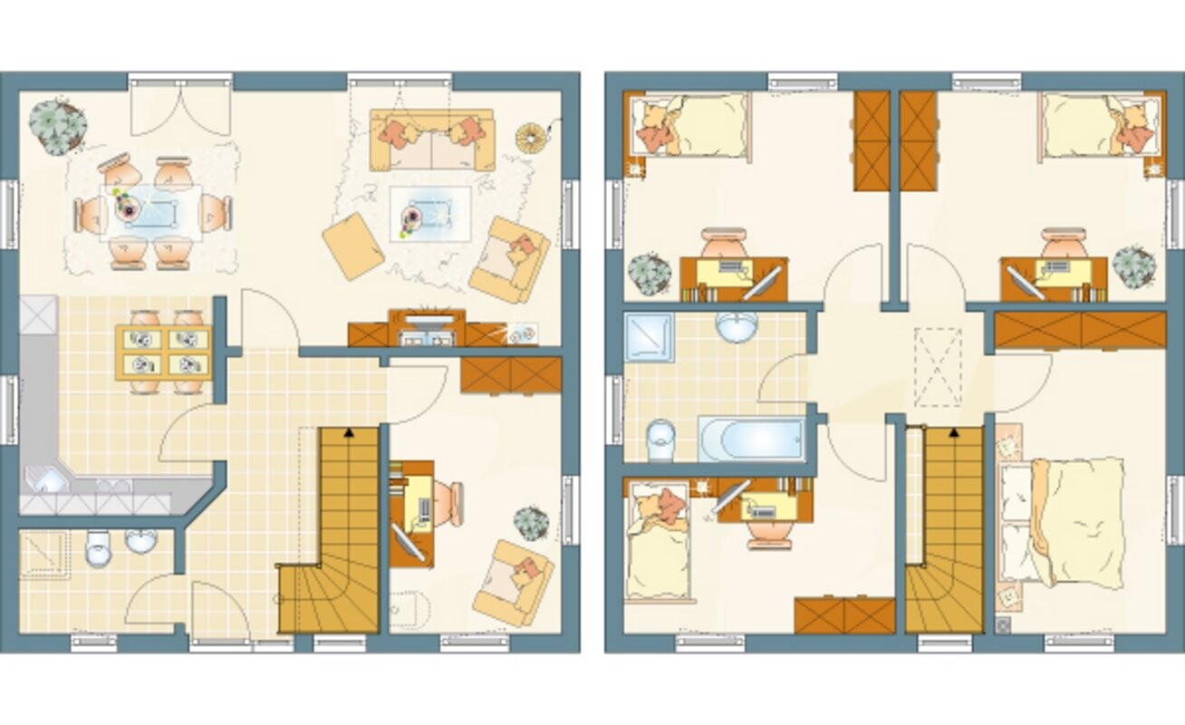

We were fortunate to be allocated a building plot and are currently working intensively on the floor plan design.
I have been following the forum for a while and have already implemented some ideas.
We are now entering the critical phase and I would like to share our planning with you. I would appreciate your feedback.
For example, would a narrow, tall window for the staircase make sense (if the door with the light strip is rotated)?
The windows at the front are rather small due to the floor plan. Do you see a better solution here? (Otherwise, it can stay as it is since we don’t spend much time there and it would mainly be for show.)
Where should the outdoor unit of the air-to-water heat pump be placed?

kaho674 schrieb:
Considering the limited square meters, family planning for 3 children really needs to be quite certain. It would be really frustrating to find out in 10 years that you actually ended up with only 2.
I agree. 140 sqm (1,507 sq ft), which is actually only 132 sqm (1,421 sq ft) because of the utility room, is highly questionable for 5 people. And if it has to be a 1.5-story house, then the whole thing is basically doomed.

kaho6747 Jul 2018 11:04
Zaba12 schrieb:
If it has to be one and a half stories, then the whole thing is basically a no-go anyway.
No, it’s quite certain that a townhouse has two full stories, I think. However, you can hardly call it a city villa.

kaho6747 Jul 2018 13:52
The Bravour 130 model by Fingerhaus might also be a good source of inspiration. The two children's bedrooms on the upper floor are said to be 13.84 m² (149 sq ft) and the one on the lower floor 11.52 m² (124 sq ft). However, I’m not sure how they achieve this given the external dimensions of 9.08 x 9.08 m (30 x 30 ft). Perhaps the wall thicknesses play a role.
Two-story floor plan: ground floor kitchen, dining room, living room; upper floor bedroom, bathroom, hallway.
