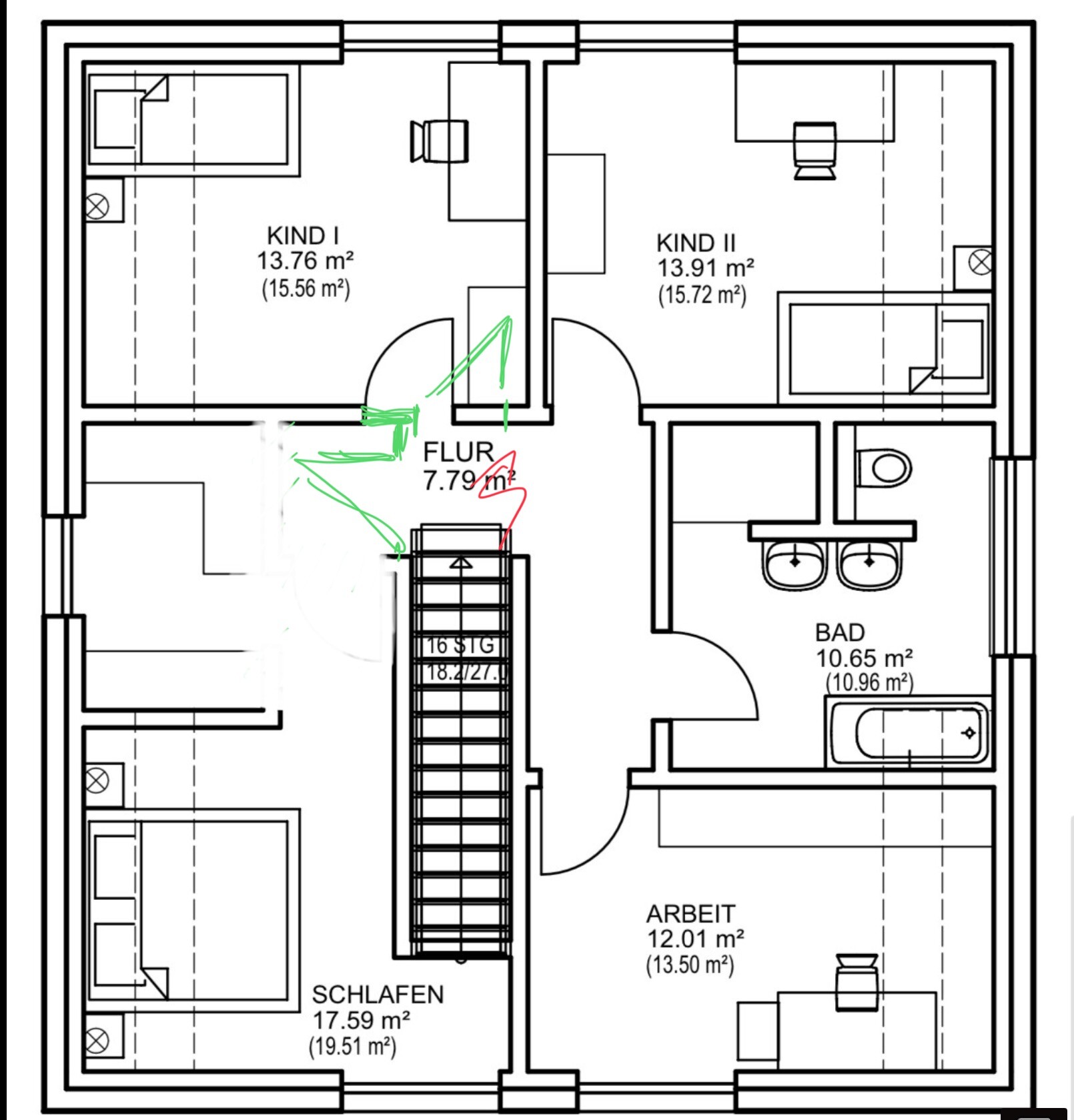

Dear all,
I could use a floor plan rant or some inspiration. We are generally quite happy, especially with the ground floor. The bay window on the ground floor is just for aesthetics and doesn’t serve a functional purpose. On the upper floor, we have two dormer gables on the west and east sides. We are also satisfied with the plot but are unsure if the children’s rooms might be a bit small.
We appreciate any input, suggestions, etc.

What is obviously a drawback, I only realize now, is that the top landing of the stairs is very tight against the wall. As mentioned before, it is difficult to judge without exact measurements. The narrow spot could be improved if the door is located opposite the stair exit, which would also allow bringing ladders and similar items upstairs.
MrNeubau2024 schrieb:
We are grateful for any suggestions. Really? Then I’ll make a radical one: back to square one!
A mix of standard designs from the general contractor combined with our wishes (cross gable + bay window) That’s probably exactly the diagnosis. I can well imagine that most of the contributors found pure standard designs more convincing than this hybrid monstrosity (just because you want a hatchback-style convertible). Blueberry ice cream with dark chocolate mayonnaise. Such “mixtures” can’t lead to anything beyond a disaster. Every attempt at improvement just increases the number of corners and dissatisfaction.
Straight, single-flight staircases are already a drawback for the layout in an older villa — and here it seems the fact that the upper story can’t be a full floor added to it, which is why the roof has bulges.
This struggle certainly won’t be solved with more contortions.
