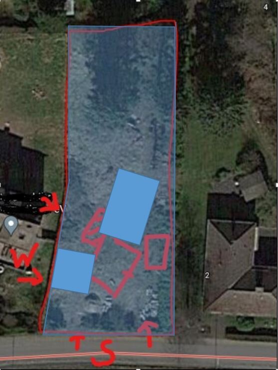

Andreas_79
Andreas_79 schrieb:
Our wish was/is actually to minimize the view of the house to the left. Even a tall hedge would hardly hide it, so we oriented everything towards the north. You don’t have to do that. You can plan windows in a way that they simply aren’t placed there—for example, corner windows. That’s part of the design. Also, consider sightlines from the sofa or dining area, for instance, where you’re looking. All of this is planned and not just sketched casually. And all these details naturally belong as fundamental parts of the planning—in this case, through the questionnaire. After the initial concept, then comes the big but.
Andreas_79 schrieb:
My wife is not happy with it at all, but we’ll have to see. Well, try explaining to a woman that she can’t wear a mini skirt anymore—then the skirt gets bought but never worn. A waste of money.
The south side is not meant to be the main terrace; it’s about quickly enjoying a coffee in the first rays of sunshine of the year.
You can mirror the layout.
Also, on the ground floor, you can compensate a lot with the outdoor area. You are not helplessly exposed to the view of the neighbor’s house wall.
hanghaus20003 Aug 2021 17:37Andreas_79 schrieb:
Are prefab house consultants (salespeople) capable of keeping track of the legal requirements? I suspect that salespeople are not architects... There are different kinds.
Some are civil engineers, others are “just” salespeople.
We had a qualified civil engineer who took note of our wishes, which the architect (from the prefab house provider) implemented as far as possible.
You’ve been to prefab housing estates yourself, right? You can quite quickly tell whether the “talk” is credible or not.
Andreas_79 schrieb:
My wife is really upset with me now because I posted this here, as she was already expecting this blunt, harsh, honest criticism. Looks like my kitchen will stay cold today :-( What happened next? Did she ban you from the internet? 😉 My recommendation for the next steps: Find a QUALIFIED building supervisor or a QUALIFIED architect and have a proper design created. The plot of land provides a very good starting point and deserves far better than the rough sketches shown here.
