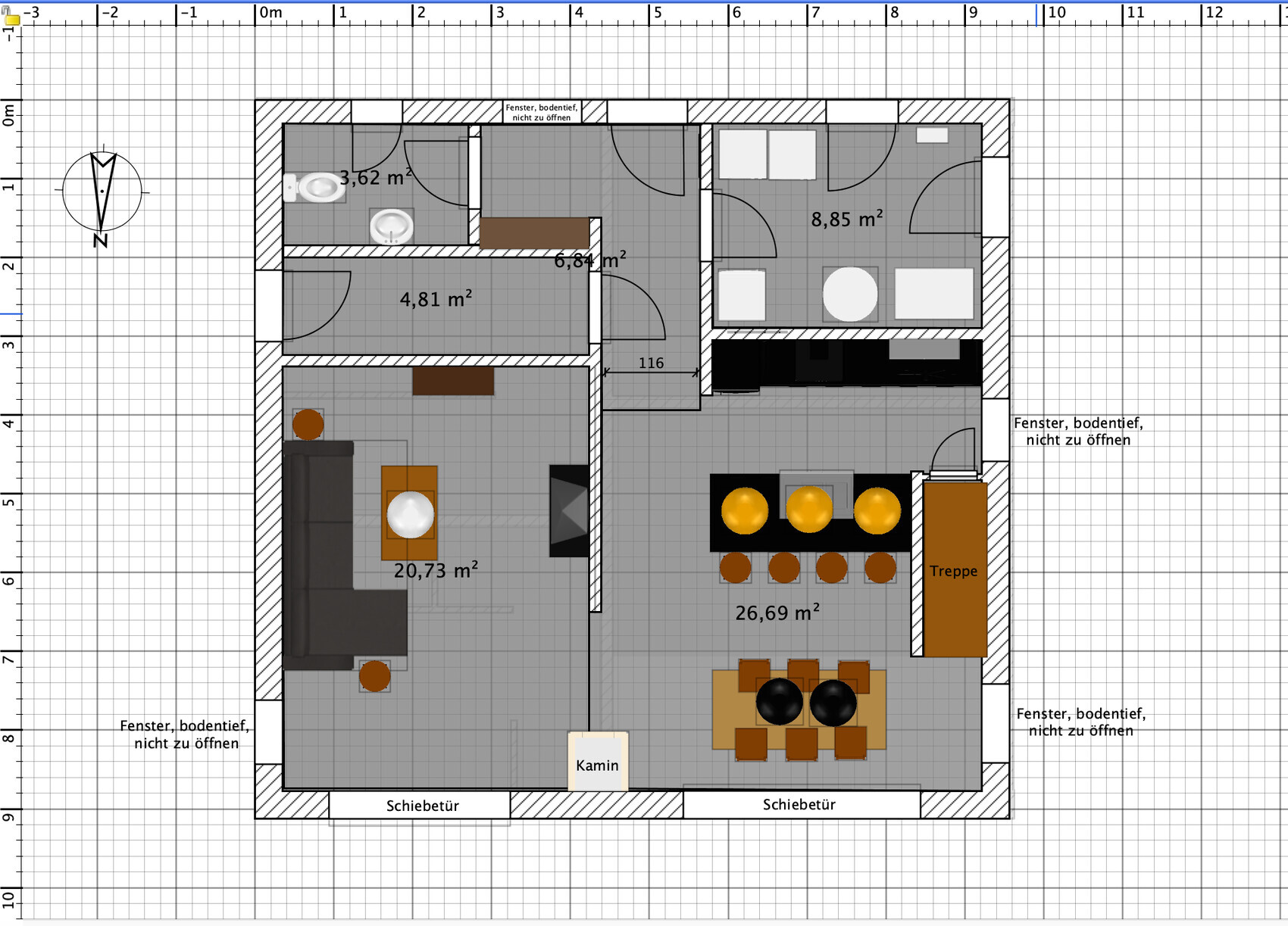

Ground floor:
2D floor plan of a house with living room, kitchen, dining area, stairs, fireplace, and bedroom

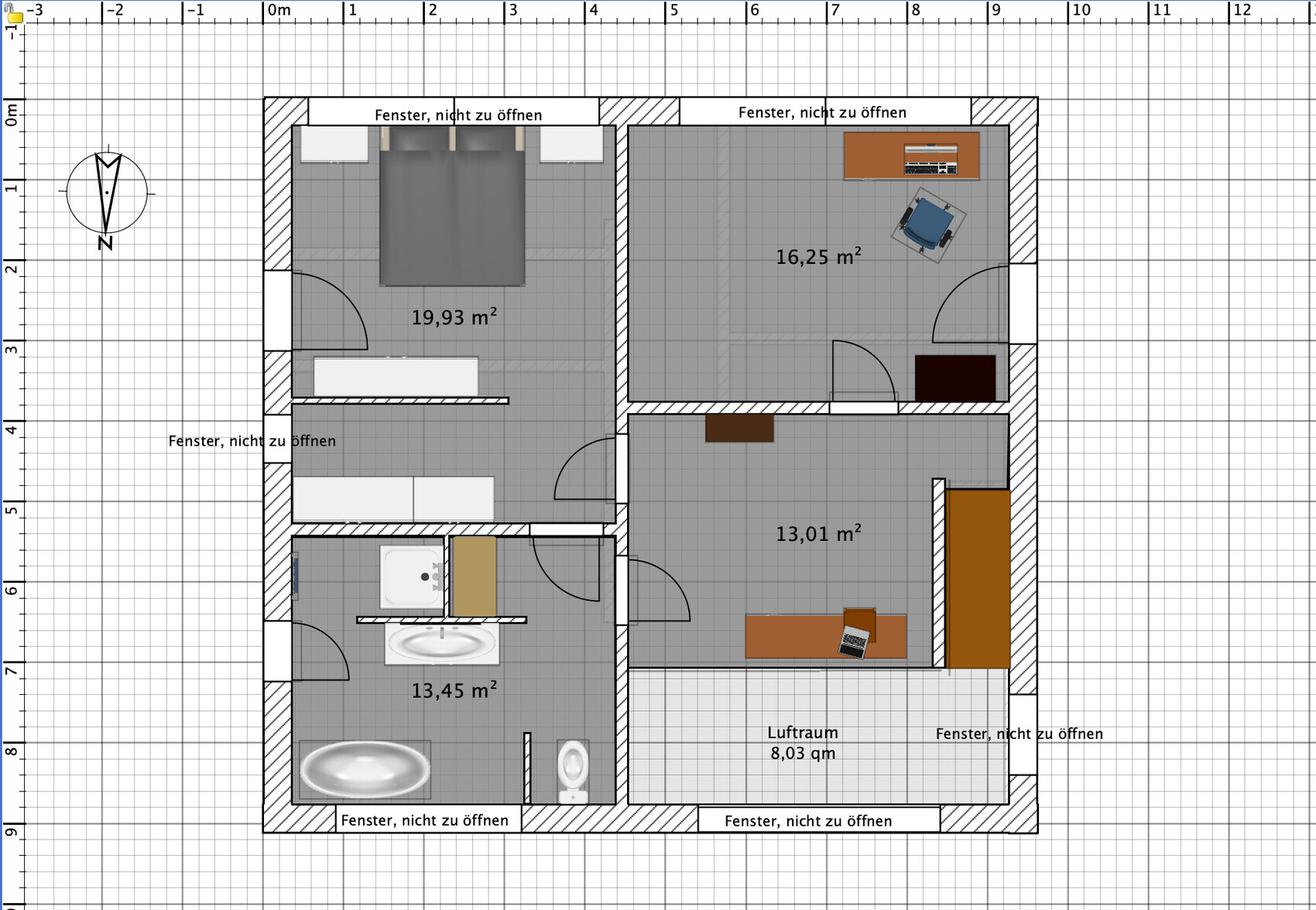

Upper floor:
Floor plan of a house with four rooms: floor areas 19.93 m² (214 sq ft), 16.25 m² (175 sq ft), 13.01 m² (140 sq ft), 13.45 m² (145 sq ft).
Thank you for reading.

driver55
3 Aug 2021 12:04
Please just toss the "thing" in the trash or press DEL. The main thing is to get rid of it.
A staircase that doesn’t work (way too short), placed in a spot that doesn’t work.
Even prefabricated house manufacturers have skilled architects.
Andreas_79
3 Aug 2021 12:10
Or simply make the staircase longer?
Gudeen.
3 Aug 2021 12:28
No, that simply doesn’t work.
At least the seating at the dining table is marked clearly. With the spacing, you would actually have to sit on the table.
haydee
3 Aug 2021 12:33
The storage room doesn’t work; it’s just a hallway, nothing more.
The staircase is way too short.
Everything feels like a game of Tetris.
What exactly is supposed to be included in the budget?
Myrna_Loy
3 Aug 2021 12:41
The staircase is at least one meter (3 feet) too short and does not work well in that location.
