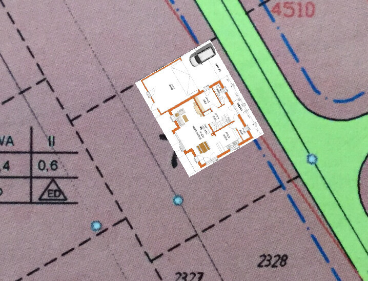

When someone here asks for a "site plan," they don’t mean simply zooming into the plot to the point where the only visible detail is which edge borders the street. Still, one can see ...
... but at least it’s clearly misleading. The conclusion "no relevant restrictions" may be correct—at least without contour lines. In the land use template shown partially on the left in image #27, you can find the permitted two full floors, floor area ratio 0.4, and plot ratio 0.6 (multiplied by 638 sqm (6868 sq ft), so indeed not restrictive in that regard). But it is obvious that there is a development plan, and one should definitely take a closer look at it (not just the image excerpt).
I roughly placed the house; I estimate the plot to be about 25.70 x 24.80 m (84.3 x 81.4 ft) (width/depth).
