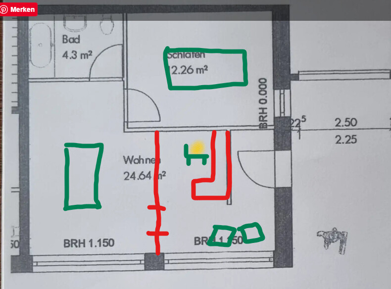

The floor plan was originally designed as a granny flat but is now intended to become a small practice. For this purpose, two rooms (15 m² (161 sq ft) + 8 m² (86 sq ft)) and a small storage room of about 3-5 m² (32-54 sq ft) are needed. All interior walls are non-load-bearing, made only of drywall.
It will be a physiotherapy practice. Does anyone have experience with this?

Unfortunately, it was originally designed as a granny flat. Everything is drywall construction, so some changes to the floor will also be necessary. The change of use is a formality and has already been applied for. Since it is not a large physiotherapy practice, but only 1 to a maximum of 2 people will be there, the 2 rooms are sufficient. A separate additional changing room is not necessary. However, how can these 2 rooms—15 + 8 square meters (161 + 86 square feet), plus 2–5 square meters (22–54 square feet) for storage and a reception area—be best planned given the floor plan? Unfortunately, the bathroom in the corner must remain there. Not much can be done at the front door, except possibly rotating it if absolutely necessary.
kati133715 Jul 2023 19:52
Floor plan of a living area with bathroom (4.3 m² / 46.3 sq ft) and bedroom (2.26 m² / 24.3 sq ft); living room 24.64 m² (265.2 sq ft).
How about something like this?
You could make the bedroom a bit smaller by moving the left wall to the right.
Edit: I forgot the storage room. Need to rethink this.
