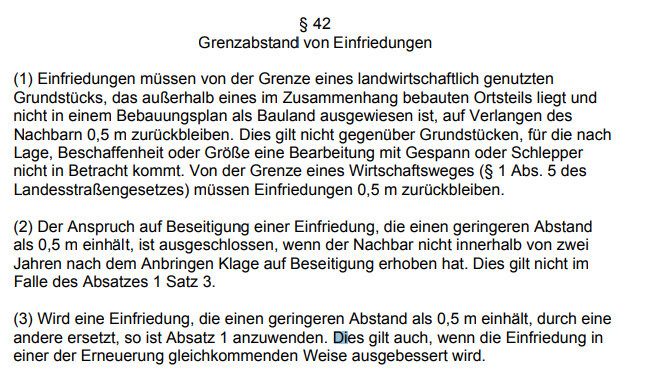

I have reviewed our development plan, and there is no mention of fencing. I have now contacted the local authority again and am waiting for a response regarding any special regulations, but as far as I can tell, the general law of Rhineland-Palatinate applies. So far, I haven’t found much except: If a neighbor has a justified reason, you must fence; otherwise, you may fence but only on your own property, unless you agree to place it on the boundary.
I personally don’t insist on a fence directly on the boundary. I would like to fence at my own expense and not too high—1.2 meters (4 feet) would be fine if necessary. My main concern is simply to know where our property ends and how far we can plant things.
Now, in the building regulations of Rhineland-Palatinate, I found only this:
Am I right in understanding that this applies only if we border agricultural land? What distance do we need to keep from the boundary with our 1.20-meter (4 feet) fence? Could we also build a 1.80-meter (6 feet) fence? The text says this:
I don’t think anything special is considered “customary” here. Some neighbors have welded mesh panel fences; others have chain-link fences.
Last but not least: What would be an affordable way to build a permanent fence? I find welded mesh panels (without those terrible plastic parts) quite acceptable visually. Chain-link fences are a bit old-fashioned, but I could also live with that. I would plant vegetation in front anyway, so the look is not very important to me. It just shouldn’t cost an arm and a leg.
